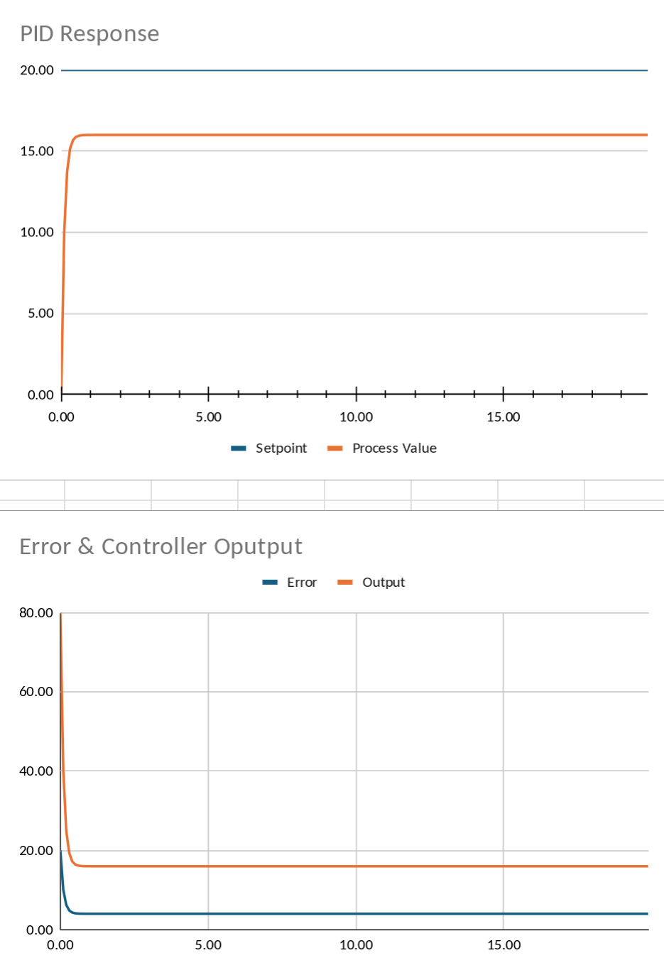

Watch where it eventually settles. With the suggested values, the process value winds up around 16 even though our setpoint is 20. Why? At a process value of 20, the error would be zero. A proportional controller presented with zero error produces zero output. But this particular process needs an output of 20 to remain at 20. Therefore, it can’t ever quite get there.
This is the classic steady-state error of proportional-only control. We could crank Kp upward. Try Kp=8. The process gets much closer to the setpoint. But continually increasing proportional gain isn’t a universal solution. Eventually real systems start overshooting, oscillating, amplifying noise, or otherwise expressing their displeasure. We need another term.

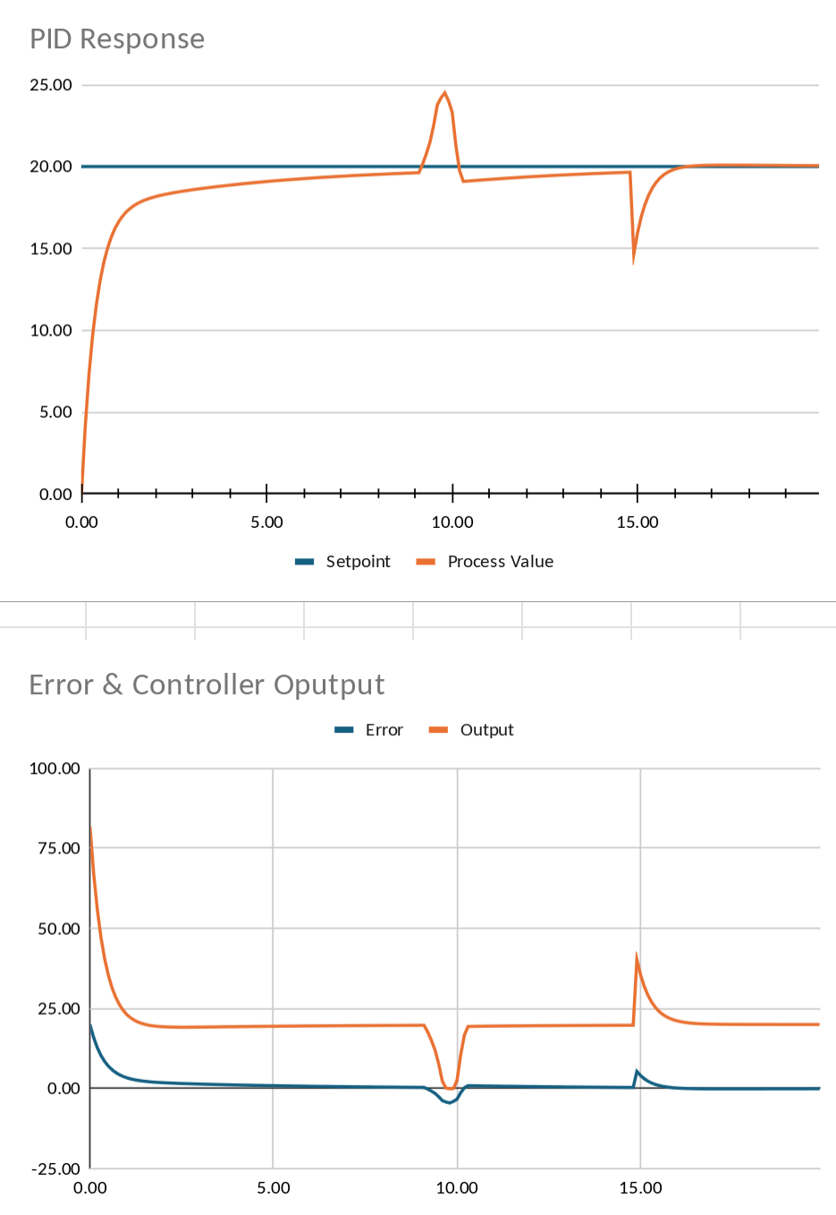

Now consider our P controller sitting stubbornly below the desired value. As long as some positive error remains, the integral keeps growing.
That gradually increases the controller output until the remaining error disappears. Instead of settling around 16, the process now creeps all the way toward 20. This demonstrates one of the major reasons integral control exists: it eliminates persistent offset. It also gives us a good excuse to disturb the system.

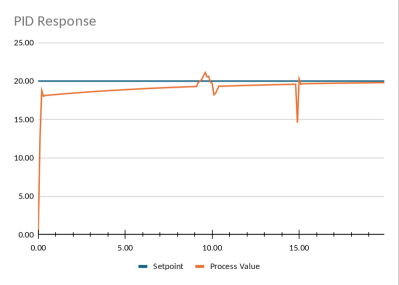

Select the user process model and set User Model # to 1. This will let you disturb the process value by entering numbers into the User1 column. Leave the first bit of the User1 column at 0. But somewhere farther down the simulation, put a disturbance into that column — perhaps -5. If you are feeling especially salty, try a sequence like: 0.5, 0.75, 1, 1.5, 2, 1.5, 0.75, 0.5, -1, -1, -0.5. That sequence should already be in the template’s User1 column.
You can imagine that as opening a refrigerator door, suddenly putting a mechanical load on a motor, or connecting another load to a regulated power supply.
A proportional-only controller reacts immediately, but once things settle, it again tolerates a permanent error.
The integral controller doesn’t. If the process remains below the setpoint, integral action continues increasing until the disturbance has been compensated. That’s a powerful trick. Unfortunately, integral control has tricks of its own.

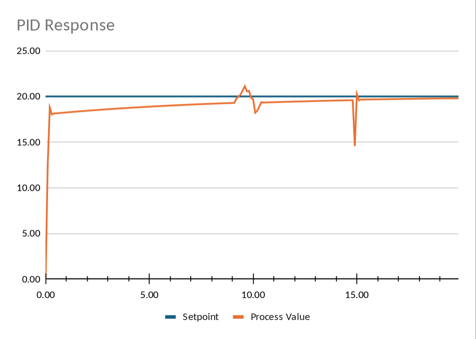

Overshoot in user model #1
The response now gets to the setpoint quickly, but it overshoots it. The problem is easy to see in the spreadsheet. While the process is racing upward, it remains below the setpoint, so the integral continues accumulating positive error. By the time we arrive at the destination, the integral term is still pushing. Depending on the process and gains, the result may be a little overshoot, a lot of overshoot, or sustained oscillation.

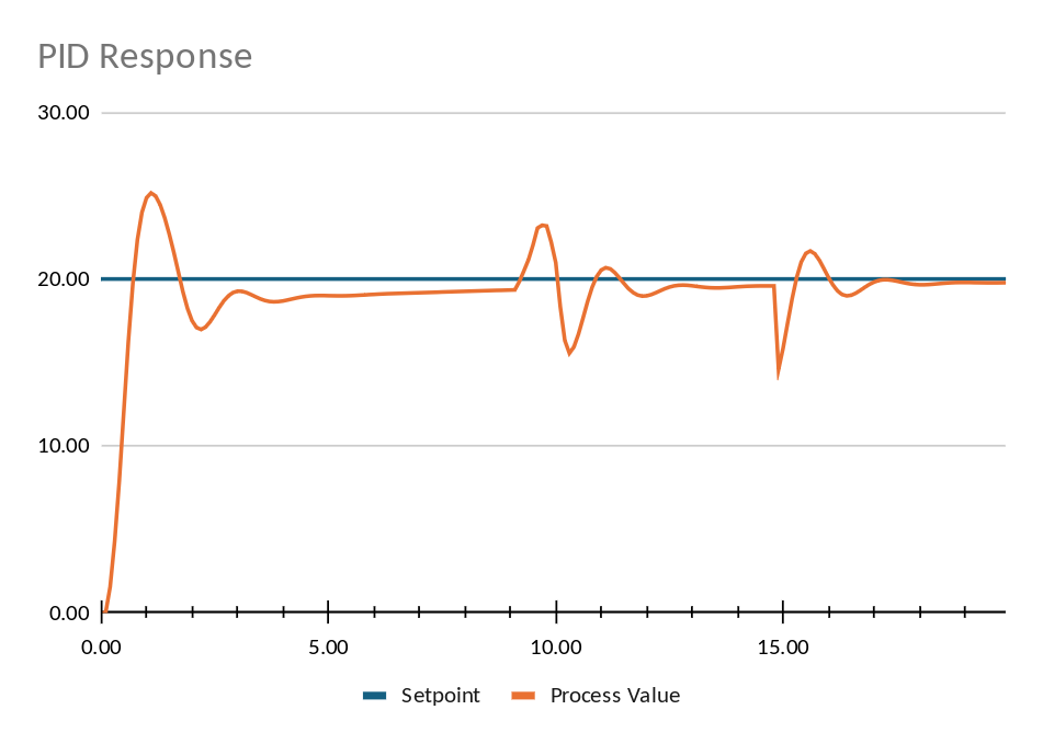

Since the default plant is only first-order, derivative action doesn’t have much to work with. User Model 2 adds another lag, using the USER2 column as an intermediate process state. That produces more phase lag and makes aggressive PI tuning more prone to overshoot.
Overshoot observed in model 2.
Switch to User Model 2 and start with Kd=0. Then note the peak process value. Then try Kd=0.2, 0.5, and perhaps 1.0. Try some negative values. You will find that there is a range where the peak overshoot is reduced slightly, but keep going and the response starts to ring. Push Kd far enough, and the derivative term becomes part of the problem rather than part of the cure. The graphs autoscale, so sometimes what looks like a peak the same size (or even bigger) is really smaller than the previous result. Be sure to read the numbers.
