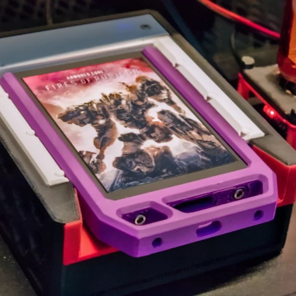

Game companies might not like physical media much anymore, but gamers sure do. There’s nothing like pawing over your collection to find what to play, and inserting a cartridge with a satisfying click before sitting down to an old-school game like — wait, Cyberpunk 2077? Yeah, that wasn’t released on cartridge, but that didn’t stop [LewdMeat]. The cartridges are 3D printed and contain old 2.5″ SSDs picked up for cheap in bulk.
This larger base seems ideal for building into a PC console, but either would work.
Inside the base unit is a simple USB3-SATA adapter that hooks to [LewdMeat]’s gaming PC. There are two versions of the base: a simple vertical unit, and a horizontal one with some springs to give a satisfying grip. On each disk is a launch script that is vetted by a program on the PC that auto-launches only the cartridges you’ve told it to trust, which is a level of security we can appreciate.
We don’t know how much life is left in these cheap drives, but they should last a while if the only write is the odd save file. Hopefully [LewdMeat] is cycling through his games fairly often, as SSDs are only non-volatile storage if your time horizon is short enough.

    2. I’m a little confused by the process. After flipping through the repo, I think what it does is just check for a trusted drive then run a script from the inserted drive that launches the game. The game doesn’t actually have be on the inserted drive, but it can be is my understanding.
      1. That makes the situation make a bit more sense to me, but if that is the case, why not do this with old USB flash (thumb) drives? You can get them for less money (or free), and the form factor is rather unimportant because if you’re designing 3D printable enclosures, you can make them however you want. The tendency for SSDs to lose data over time when unpowered seems like huge oversight.
        1. It’s even worse in thumbdrives, due to lower quality (cheaper) flash and simpler controllers with no wear-leveling.
