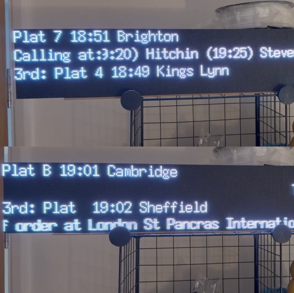

Trains are a great way to get around. You just have to make sure you’re across the schedule if you intend to get where you’re going in a timely manner. Train departure boards exist for that very purpose. As a train fan, [Jon] always wanted such a thing, so decided to build one for himself.
The build started, as so many do, with a Raspberry Pi 4, with [Jon] deciding on the 1GB model. Hooked up to either an Adafruit RGB Matrix Bonnet, or an Electrodragon 3-port RGB Matrix board, it’s then possible to get the Pi running three to four HUB75E LED matrixes. Each matrix consists of 128 x 64 pixels, so stacking up a bunch of them can make a nicely-sized departure board that’s easily readable. [Jon] was sure to hook up a nice, juicy 5-amp 5-volt power supply to ensure there wouldn’t be any surprise brownouts under normal usage conditions. From there, it’s simply a matter of having the Pi query the Rail Data Marketplace in order to get the relevant schedule data to display on the board.
If you want to get information on your local rail services at a glance, or just want to impress your fellow foamers at your next railfan gathering, a build like this is a great way to go. We’ve seen similar builds before, too. Video after the break.
