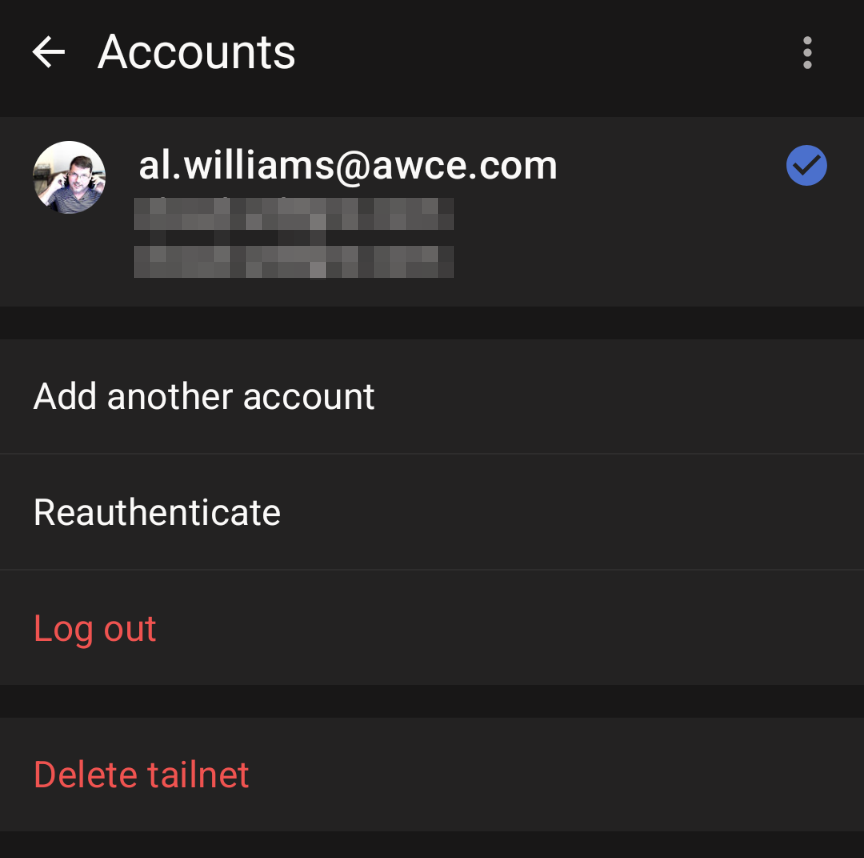

Even the Android client can take an alternative server, although it is tricky to find. In the accounts page, you have to open the “three dot” menu to reveal “use alternative server.”

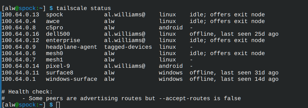

Even with this set up, you are still using the public DERP servers, or, at least, you might be. If you look at the status of an active connection, you’ll see something like this:
active; offers exit node; direct 158.61.222.64:41641, tx 428 rx 348
The direct keyword means your computer and that node are directly connected. In that case, you aren’t using any DERP server at all. It is possible to run your own DERP server, but that may or may not be a performance problem. If your cheap VPS is running halfway around the world, pushing packets back and forth could get slow. Keep in mind, the DERP servers only handle encrypted packets they can’t read, so for most people, you are probably better off at least starting with the public servers.

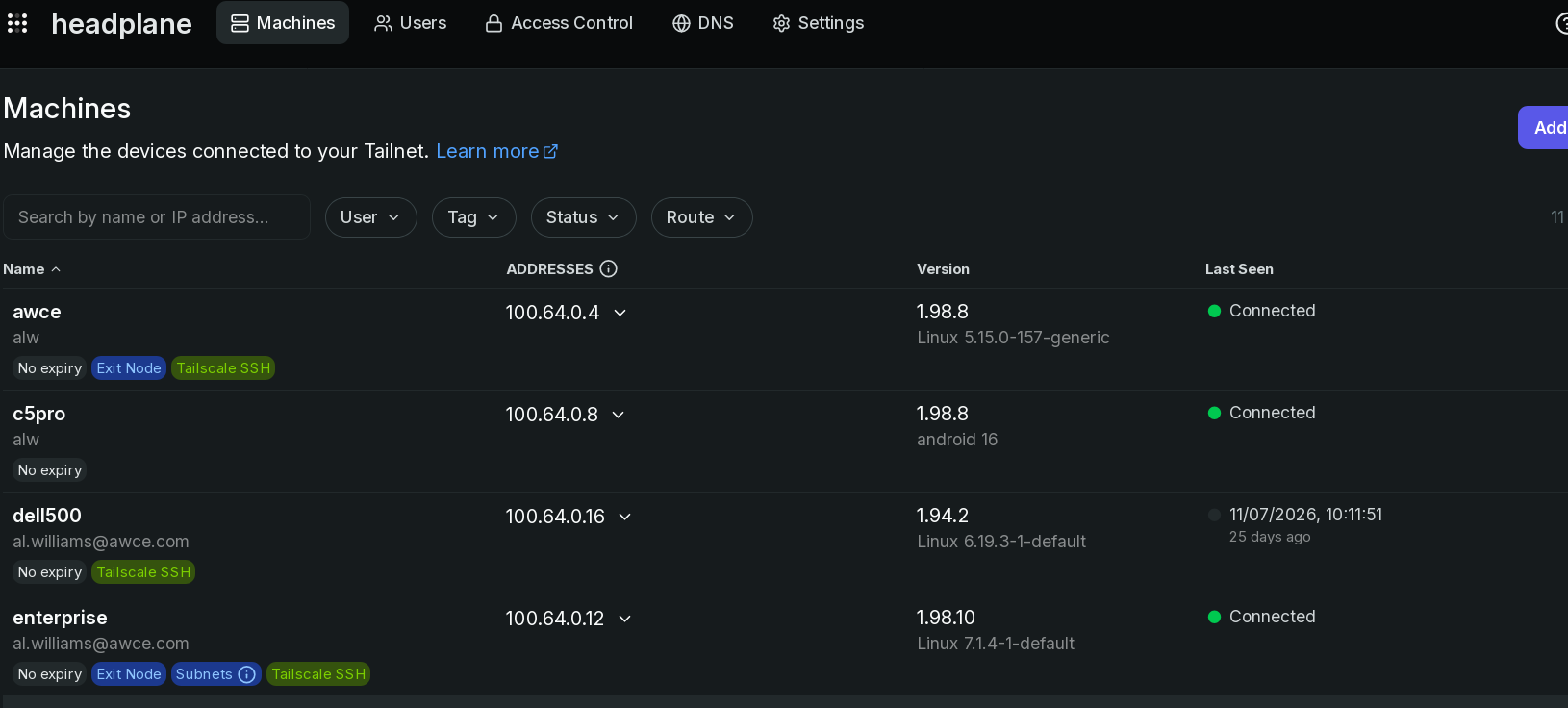

HeadPlane
Headplane makes it easier to administer your network
Headscale itself is unapologetically server software. Administration is primarily through configuration files and the headscale command.
I don’t mind that, but Tailscale’s web dashboard is undeniably convenient. Headplane offers something similar. It is a separate open source project that provides a web administration interface for Headscale. It can display and manage machines, routes, users, ACLs, tags, DNS settings, and other parts of the network. It also supports OpenID Connect for authentication and can even provide browser-based SSH access.
If you’ve used the official Tailscale administration interface, Headplane makes a self-hosted installation feel much more familiar. The usual deployment is in a container. Headplane talks to Headscale using an API key, which you can generate as part of the install process.
Exactly how you set it up depends on how you have Headscale deployed, so the exact steps I took may or may not help you. And, of course, you probably want to secure the interface either behind https or keep it accessible only via the Headscale network.
One thing that Headplane can do is allow you to have a tailscale ssh session into a machine via the browser. This turns out to be a pain to set up, but it does work. If Headplane doesn’t suit you, there are other options.
