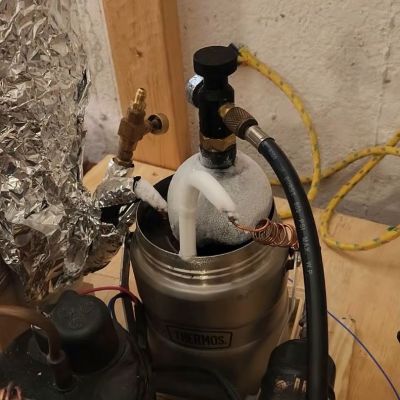

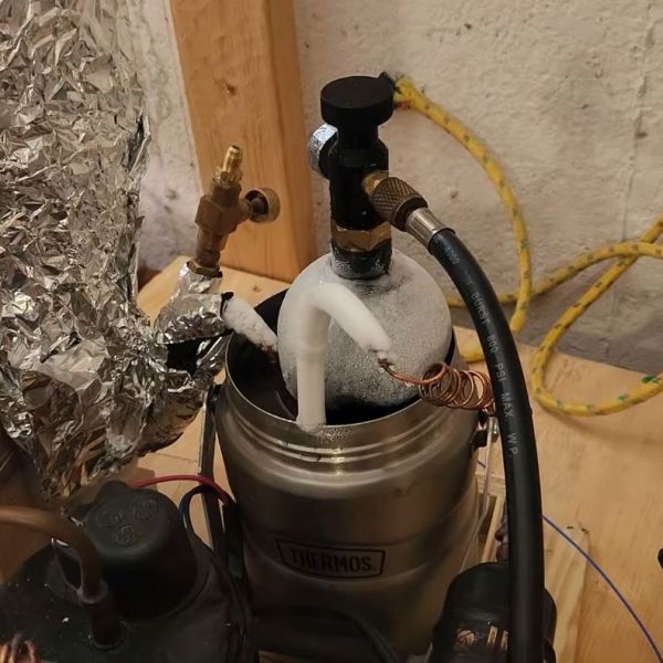

After previously using the fermenting of sugar to obtain ethanol fuel, [Hyperspace Pirate] figured that it’d be a waste to just blast the other half of the yeast production in the form of carbon dioxide into the air. This poses the slight problem that gaseous CO2 is fairly bulky, while compressing it into a liquid isn’t exactly for the faint of heart. This of course means that it’s a fun challenge, involving a beach ball, vapor-compression and various compressors.
Although at room temperature compressing CO2 into a liquid requires quite extreme pressures, if you lower it to freezing temperatures it becomes quite feasible to use more typical off-the-shell compressors.
In the video both oil-less and regular compressors are used, mostly because ultimately you want to get pure CO2 into the bottle, without oil or water. Here a few methods are explored, including a pre-cooler with the oil-less compressor as it cannot quite hit the same pressures. With a typical compressor linked to an oil-separator you can directly fill the tank, which is pretty nice, though even with this removal of water turned out to be a chore.
Desiccating the gas that comes out of the fermentation vat, is attempted using a converted water filter that’s filled with desiccant beads, but as the later tests show, this isn’t quite good enough to prevent moisture to make it into the bottle and clogging its nozzle. Of course, moisture here is more acceptable than oil for most applications, so with some more work this could be quite a feasible method to fill bottles with liquid CO2 for various nefarious applications like paintball guns and more.
