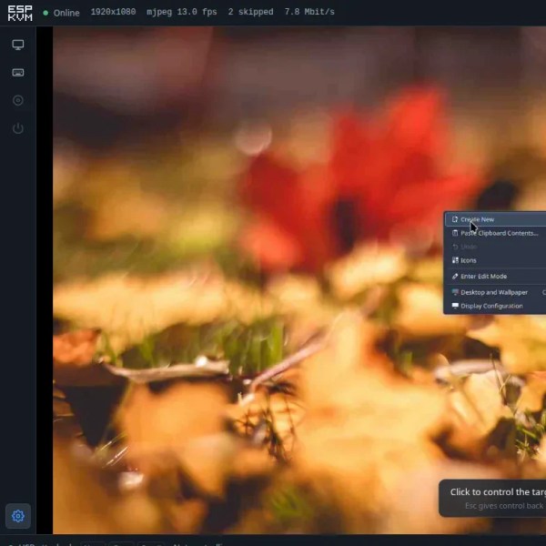

[Evgenij Spitsyn] spotted a KVM build on these very pages some time ago. That inspired their own build, leveraging the versatility of the ESP32-P4 microcontroller.
The concept is straightforward. Named the ESPKVM, the device is designed to hook up to a computer’s HDMI and USB ports. It captures the video output, while presenting itself as a standard keyboard and mouse device. In this way, it allows remote control of the machine over IP. It achieves this feat with the aid of the Toshiba TC358743 HDMI-to-CSI bridge, which is essentially the video capture hardware of the build.
The video output of the machine is streamed in MJPEG or H.264 format. The device is capable of serving up storage from a micro SD card or the onboard flash, as well as handling things like power/reset control and wake-on-LAN. All in all, it’s a very complete package, and full of useful features. Just don’t use it over the public internet yet — [Evgenij] notes it hasn’t been reviewed for potential security holes yet, even though it has some basic authentication features baked in.
If you’ve got an ESP32-P4 ready to go with a TC358743 HDMI bridge, you can actually head over to the ESPKVM website and flash the code right in your browser to get going. Meanwhile, if you found this build interesting, you might like to scope out the one that inspired it. If you’re cooking up similar utility hacks, be sure to notify the Hackaday tipsline.

  2. I have one of those NanoKVM in a drawer somewhere I wanted to use. But this is like an equal alternative. Make it run via esphome so you can also monitor it :D let’s see which one turns out to be cheaper!
    1. Hmmm… Good idea on the monitoring – that’s going on the roadmap (temp, power state, viewers, uptime). ESPHome itself won’t fit (the firmware’s a big custom ESP-IDF app, not something that runs inside ESPHome), but I can expose the same telemetry over MQTT – which also works with Home Assistant if you use it. ;)
      1. Hey, thanks for the heads up. Yeah Im trying to stay clear of Mqtt for the time being. I prefer native Communications ;) ( and too lazy to add more failure points)
        As for esphome, it is also based on esp-idf, so in that sense .. Esphome can do webcams, so why not hmdi?
        To bad the hardware is far more expensive then I’d want splurdge ATM. 35 for that HDMI to CSI is brutal. So the combined cost is almost the same as the nanokvm then. Which does come with a display, connectors etc and runs Linux (though that’s not a requirement of course(
        1. Hey, small update – it’s actually done now :) It does Home Assistant over MQTT with auto-discovery, so it just pops up as one device: temp, viewers, resolution/fps/codec, HDMI signal, USB, target power (if you wired ATX), plus power/reset/Wake-on-LAN/restart buttons. No YAML to write.
          On ESPHome: yeah, it’s esp-idf too, but the camera stuff there is for little sensor cams, not a TC358743 CSI bridge running through the hardware H.264 encoder with USB HID and a TLS web server on top. That whole pile just won’t fit inside ESPHome, so it stays its own firmware. And totally with you on the C790 – that’s the pricey bit, wish it were cheaper myself.
