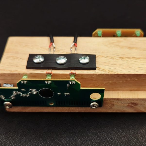

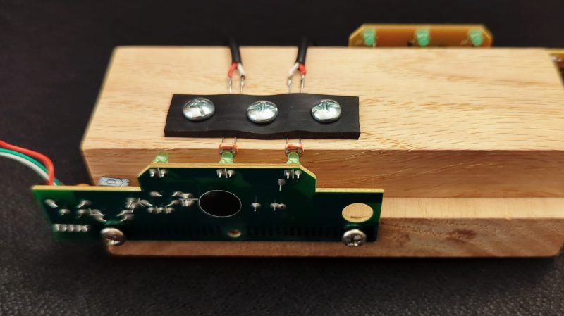

What do you do when you need to get data into an airgapped machine? Well, you might find yourself limited to basic input devices to interact with the computer in question. As [Nikolay Valentinovich Repnitskiy] demonstrates, though, you can do some fun stuff amidst such limitations.
[Nikolay] created what he calls a “unidirectional network” connection via a keyboard. Specifically, he took two Dell SK-8115 keyboards, and stripped them down to their controller PCBs. On one, he soldered photoresistors to a couple of the keyboard matrix pins, such that they’d fire a keypress when lit up. He then placed the other keyboard PCB such that the Num Lock and Caps Lock LEDs are lined up with the photoresistors. This made it possible to have one PC flash the keyboard LEDs in order to “type” on the other machine. This can be used to move data on to it, such as a little program which [Nikolay] prepared which can be made executable and used to further break into the machine and make it easier to pull data across more efficiently in future.
We looked at an earlier version of this hack some time ago. If you’ve been imagining creative ways to talk to airgapped computers, be sure to let us know on the tipsline!

If write out-only is the goal, it seems UART would be infinitely easier.
Of course. But this is targeting locked down systems. I worked at a place that had their PCs set up to disallow any USB devices other than mouse & keyboard. Flashdrives and USB to TTL devices just wouldn’t work.
Now if the target PC just lets you plug any old usb keyboard HID device in, you could program a rp2040 or similar to spoof a keyboard and convert the “caps lock” LED to a low baud UART. No need for real LEDs & photo-resistors.
If the target PC allows any HID device at all, then you could spoof a braille HID device. Those allow writing 8-dot braille out. This would be a much faster way to extract data.
