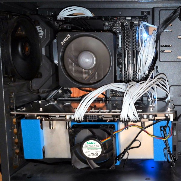

As we’ve seen many times before, there’s usually some way wrangle a bit more life out of what would otherwise be considered old and obsolete technology. Perhaps one thing that has been passed over by the masses a bit to early is older datacenter GPUs, which is understandable in one sense because of the rate NVIDIA is pumping out new ones, but these cards have plenty of useful life left in them for the average person, as [Andrew] demonstrates.
The cards [Andrew] is using are Tesla V100s of 2017 vintage. Despite being older hardware they have high-speed memory which allows them to run modern LLMs locally, competitively with online models. In this test, Gemma 4 26B and Qwen3 35B are run, with Gemma being a bit faster because it fits entirely in GPU memory and Qwen3 being a bit more capable but more hungry for resources. [Andrew] built a PCI card that can host two V100s, allowing these larger models to fit completely in memory.
Even though these don’t perform at the same level as the latest top-tier online models, they’re surprisingly capable and also have the benefit of running completely locally. This might be concerning for those looking at the global economy being propped up by companies that essentially have no moat for motivated users, especially as more and more datacenter hardware becomes available on the secondhand market. While this build by [Andrew] goes into detail on getting the software stack up and running, we recently featured another build using the same GPUs that focuses a bit more on hardware for those looking to get started with local hosting.

  1. It’s built in Windows? I haven’t researched running my own LLMs yet but it’s on my list of things to do. Is this normally done in Windows? I assumed it would be Linux. He said he tried WSL first and it required using some stuff I don’t know anything about yet that was slower. Ok. Was it because it was WSL and not bare Linux? Or are LLMs actually Windows bound?
    If it means running Windows this one just got knocked even farther down the future project list.
    1. nah he’s got linux builds avail too. IDK why he’s got such a windows fetish, but from what I can see you could trivially point an agent at his blog and github and get a setup running on linux.
    2. The LLM is not bound to a Platform. You can run it on Windows, Linux, your Smartphone.
      As long as your Hardware supports it, or vica-versa, it will work. There are dumbed down versions with simplified weights, that need less memory. But a Smartphone with 16GB will do quite well.
    3. Was it because it was WSL and not bare Linux?
      That’s the main reason, and it primarily applies to these datacenter GPUs.
      For the V100 (and other compute-focused nvidia GPUs), nvidia’s windows driver defaults to a special mode – TCC (“Tesla Compute Cluster”), which is designed solely for compute, not graphics acceleration.
      TCC doesn’t support passthrough to WSL, so you have to force the card back to the standard Windows driver, which is slower. That’s WDDM, which stands for “windows display driver model”, I believe.
      Consumer GPUs always run in WDDM mode, so this doesn’t matter. In my experience with the 2080 and 3090, they perform about the same in WSL as they do in Windows.
      From what I understand, the Nvidia Linux drivers already provide the increased performance of “TCC mode”, so presumably straight Linux would be the best option for the V100.

        1. If you’re working with large AI models, there’s an advantage to going native Linux vs WSL (and potentially native Linux vs native Windows). It’s not “performance” per se, there’s just more free GPU and system memory available, so you can fit larger models or more layers into memory without offloading.
          Otherwise, the difference is pretty minimal. not so much. For GPU-heavy AI work, my experience is that WSL usually runs +/- a few percent of native, within the the margin of error.
          It’s not all rosy; CPU-bound tasks have a bigger performance penalty, up to 15% or so. And things that do heavy disk read/writes can be worse still.
          So if you’ve got a dedicated linux box to run AI models, it’s likely the better choice. But if you’re stuck with Windows, I find running WSL is often still a better option than dual-booting linux or dealing with the hassles of running models directly on Windows.

        1. Currently all datacenter GPU’s use a socket called SXM. It is a socket that combines PCIe, NVLink and Power in two sockets. Even the newest SXM7 still uses plain PCIe5.0. The benfit is that the GPU’s can talk to eachother via NVLink, because PCIe 5.0 x16 is quite a Bottleneck for these GPUs. If you only have one GPU to run, then the adapter for PCIe and Power is all you need.

    1. That’s what this is, the PCI-E adaptor PCBs are third party manufactured and were never offered by nvidia. The single card ones are quite cheap. The dual card ones barely make sense financially, but are still the cheapest way to get dozens of contiguous VRAM.
      Nvlink gives 6x the bandwidth at half the latency of PCI-E, with next to zero CPU overhead.
