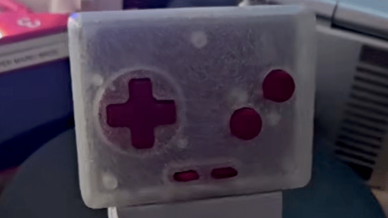

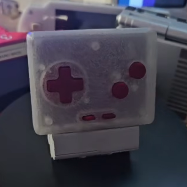

[Gil Yankovitch] noted that playing games on a touchscreen phone gave up a certain something in terms of the tactile feedback one gets from real buttons. To that end, he was inspired to build a controller specifically for phones that solved this very problem.
The result was JoyFon. It’s a small gamepad built around the Raspberry Pi Pico, and can be put together around an RP2040 or an RP2350 as desired. It has four face buttons, a directional pad, and start and select buttons, as well as additional shoulder buttons up top in later revisions.
The JoyFon enumerates as a standard USB HID gamepad, so you could use it to play games on just about any PC, laptop, or tablet. However, the JoyFon is specifically designed for use with smartphones in the vertical orientation. This guided the design of the 3D printed enclosure, which positions the USB-C port to plug into the base of a phone, such that the buttons sit neatly beneath it. It does cover some of the phone screen, but that’s not always a problem when playing emulated games with a 4:3 or similar aspect ratio. The result is a button and screen layout not dissimilar to that of the original Game Boy handhelds.

  1. I have to say I appreciate the hinged design for the base of it. I have a Hyperkin Smartboy that I bought for the physical buttons (and cartridge slot) and not being able to access the UI elements on the bottom of the screen was a big headache, so being able to flip the buttons out of the way to access things is a much better design.
