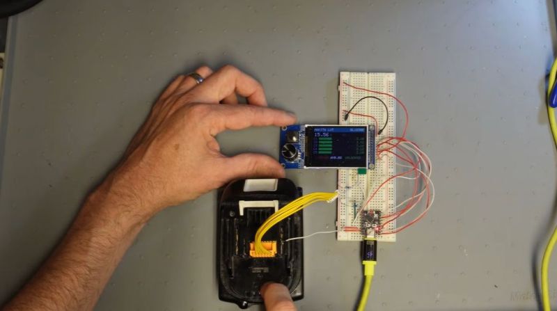

It’s no real secret that battery packs for power tools aren’t the foremost when it comes to user serviceability, so if said battery pack suddenly stops charging outside of warranty, you generally just e-waste it. That’s what [The Repair Forge] could have done for the Makita battery pack in question, but instead it was opened up for a diagnosis and fix.
Rather than the charger throwing up an error with this specific battery, it would flash its red LED and run its fan, but never actually start the charging process. Apparently the charger seems to think that the battery is either too hot or cold to be charged, which already gives a big hint as to what might be wrong.
Using the open source PocketOBI tool it’s possible to query the battery, which showed that one of the internal thermistors reported the battery being at a chilly -30°C while the other a more reasonable 28°C. After popping open the pack and measuring the thermistors, the faulty one registered as infinite resistance thus confirming that it had failed.
By putting in a temporary resistor this diagnosis was confirmed, thus the next step will be to replace said thermistor. This same procedure was then used with a second battery, whose thermistor read a wild 64°C.
Overall it’s a pretty easy fix, using a 20 cent part, with the entirety of diagnosis to repair taking maybe ten minutes when using a tool like PocketOBI, itself based on the great Open Battery Information project that originally reverse-engineered the Makita battery protocol.
