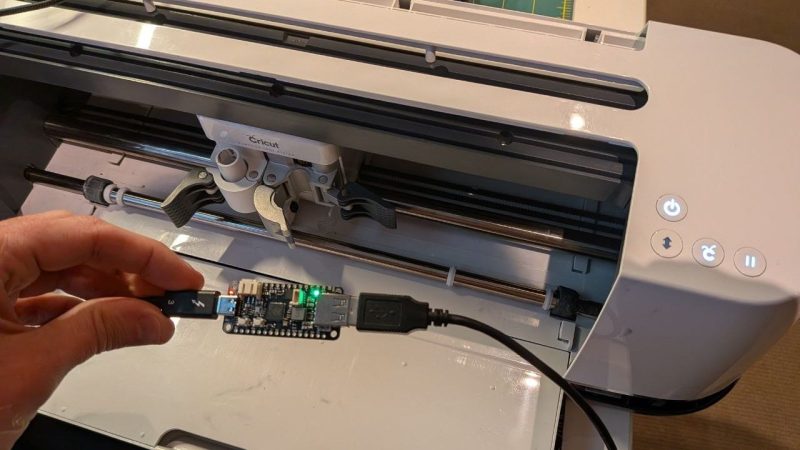

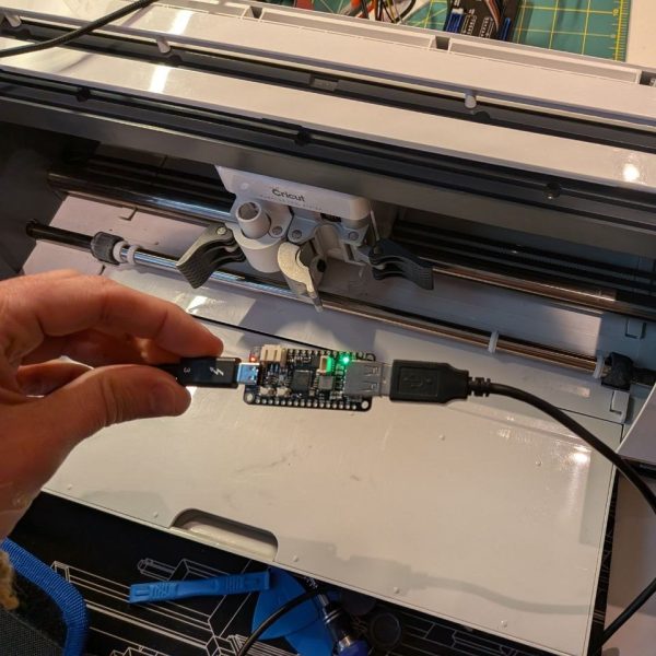

[xssfox] recently found a Cricut Maker in an e-waste disposal. A quick scan over the device indicated it was in moderately good condition, with merely some perished rollers to contend with. The device was salvaged, with the awareness that Cricut is plenty good at disabling and locking down machines when it wishes. However, those measures didn’t stop [xssfox] from bringing it back to life.
The suspicion was that the machine had been locked out after the original owner received a warranty replacement or similar. Whatever the reason, the rollers would have to be repaired and the machine unlocked if it were ever to cut (Cricut?) again. Hooking the machine up to Cricut software showed that it was “deactivated”, so there was work to do.
The rollers were not a difficult replacement, but the hacking would take a little work. Examining the motherboard didn’t reveal any obvious EEPROMs, and the microcontroller was not one [xssfox] had the debugger to work with. Thus, attention turned to intercepting communications between the machine and the host PC over USB. This revealed the machine sending its serial number to the Cricut PC software in plain text with no checksums or encryption at all. Unlocking the machine was as easy as installing an RP2040 in between the Cricut Maker and the host PC. It was programmed to relay packets between the two and spoof the serial number in the process.
[xssfox] suspects a software-only solution may be possible, too, though hasn’t implemented one yet. We’ve featured her work before, too, like her efforts to spoof emergency traffic light preemption signals.

Some of it is described in the article. The software reads the serial, checks for it, and if it is disbled , refuses to work with the printer. What she did was masquerade the printer as someone´s printer, so if something wrong goes in the software, the other person printer will stop working. Not very nice, and these could be considered more of a security bug on the cricut framework than a “unlock” mechanism.
Printers check for firmware updates by telling the servers their model, serial number, etc. If a device is scheduled to be deactivated, it gets served an ‘update’ that is just firmware that bricks it.
While trying to determine how this all worked, Xssfox possibly bricked numerous printers.
