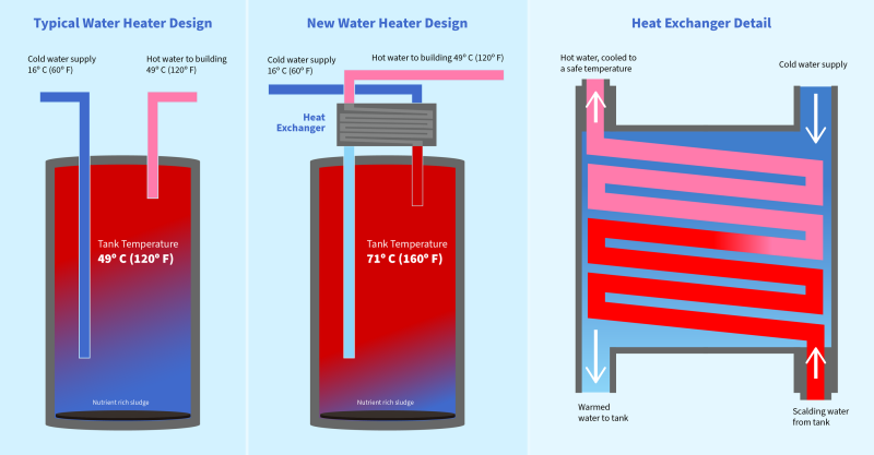

The solution developed by NIST is simple—jack up the set point of the hot water heater, then fit a heat exchanger on top to cool outgoing hot water with the incoming cold supply. Credit: Brandon Hayes/NIST
The simple solution would be to simply jack up the hot water system to store water at a much higher temperature, say around 70 °C (160 °F).  This could be undesirable in many contexts, though, as water that hot can more easily cause burns. It would be ideal to store the water at a higher temperature, while making sure it was delivered at a slightly lower temperature so it didn’t hurt anybody when it left the tap or shower head.

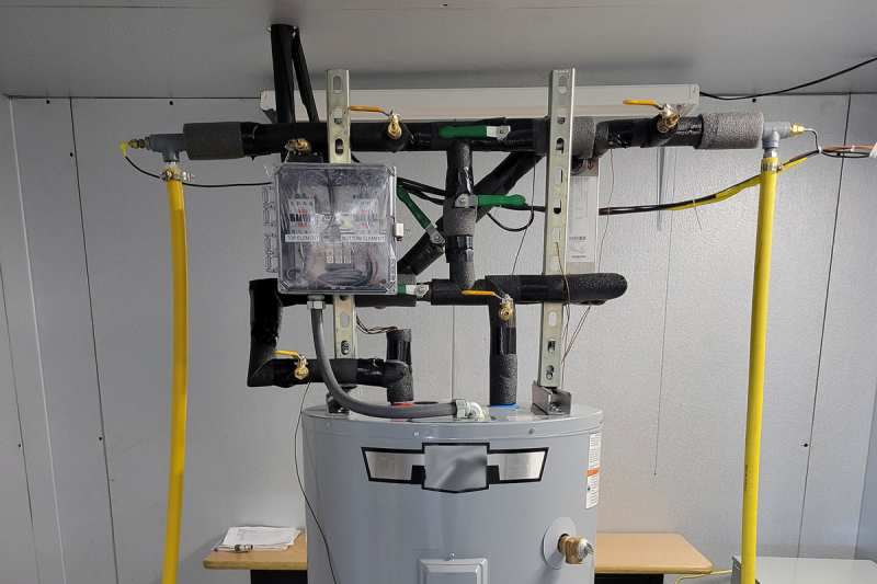

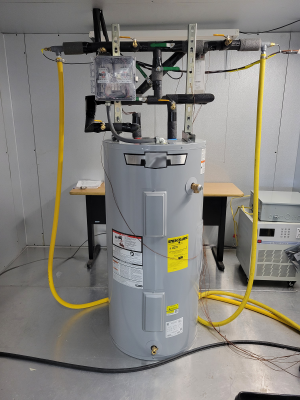

A prototype unit whipped up by NIST cost only about $100. Credit: NIST
It turns out that there is a remarkably simple way to achieve this. NIST developed a simple heat exchanger which can be mounted atop any old hot water system. It’s designed such that the hot water leaving the tank passes through a heat exchanger where it’s surrounded by cold water which is running to the water heater’s intake pipe. This has dual benefits. The hot water inside the tank can be stored in the tank at 70 °C, which kills almost all legionella peumophila almost instantly. That water, though, is then cooled to a slightly safer temperature as it passes through the heat exchanger and out to the tap or shower. The hot water remains at a safe temperature for the user, and contains far less harmful bacteria, and cooling it doesn’t introduce any pathogens from another source. In turn, the cold water coming into the tank is pre-warmed slightly by the hot water, so the energy isn’t simply wasted.
This trick isn’t just simple, it’s also cheap. NIST engineers were able to fabricate a prototype unit to fit to a residential water heater using just $100 of components. It could be a useful addition for homeowners looking to make their hot water service a little cleaner. However, the real benefits are likely to be for larger operators of multiple-occupancy facilities, like nursing homes and hotels. These facilities often have to take great care to avoid the build up of harmful bacteria in building-wide hot water systems. Having the ability to increase the tank temperature to the point that legionella pneumophila bacteria simply die off would be a huge boon to this effort.
Sometimes, it’s possible to make great gains with a simple hack. Using the cold water service to cool hotter outgoing water is a smart trick that uses only minimal additional equipment to offer a safer hot water supply. It could yet become a common install for hot water systems in order to fight the good fight against a harmful disease that likes to lurk in our pipes. If you happen to see a heat exchanger atop a hot water heater in future, you can smile that someone has done the work to try and make that hot water supply just a little safer going forward.

    2. Mixing cold with hot to cool it is incredibly less efficient than using a heat exchanger to cool it.
      Mixing hot with cold directly = burning money
      Using a heat exchanger to cool outgoing hot water, uses that “waste” energy to preheat the incoming cold water. And because the incoming cold water is now hotter the amount of energy required to heal the preheated cold water is considerably less.
      1. I’ll assume you’re just ignorant so I’ll explain it.
        Think of the system as a whole. The same amount of cold water comes in to the system as hot water leaves. The cold water coming in is same temperature in both systems. The hot water coming out is the same in both systems.
        How is one more or less efficient than the other?
        With a tempering valve you store less water at a hotter temperature and use less of the heated water as it’s mixed with cold on the way out.
        With this heat exchanger you need to store a larger volume of water at a lower temperature.
        The only way there can be efficiency differences is in the system losses.
        A hotter storage tank needs more insulation, but with a tempering valve the temperature can fluctuate, so off peak power usage and solar is easier to take advantage of.
        An external heat exchanger also needs insulation. It also increases the volume of water that needs to be flushed through before hot water comes out the tap at the end. Wasting time, water, and energy. The outlet temperature will also change with flow rate, as the heat exchanger doesn’t have zero thermal resistance. It will get hotter as the flow increases due to the water spending less time in the legal exchanger

  23. Using a heat exchanger is a default solution for solar tube systems, at least in Europe, for several….. decades!
    But not on the top but inside the tank.The idea is that the water in the tank is surely contaminated but you never use it. The heat exchanger pipe inside is not long enough for water to grow legionella.
    This (very common) tank is mandatory for all solar tube solutions in the Netherlands. It is the only solution against legionella without periodic heating, which is impossible for the size of tanks for solar tubes (500 to 5000 liter). This is called Hygiëneboiler in Dutch, and probably translates to Hygenic Tank in English…
  24. Boilers in europe often only raise the temperature for a short time period enough to kill the bacteria, while idling at lower temperature. This is possible, since the bacterial growth takes some time. Therefore it is not necessary to keep the heat on all the time.
