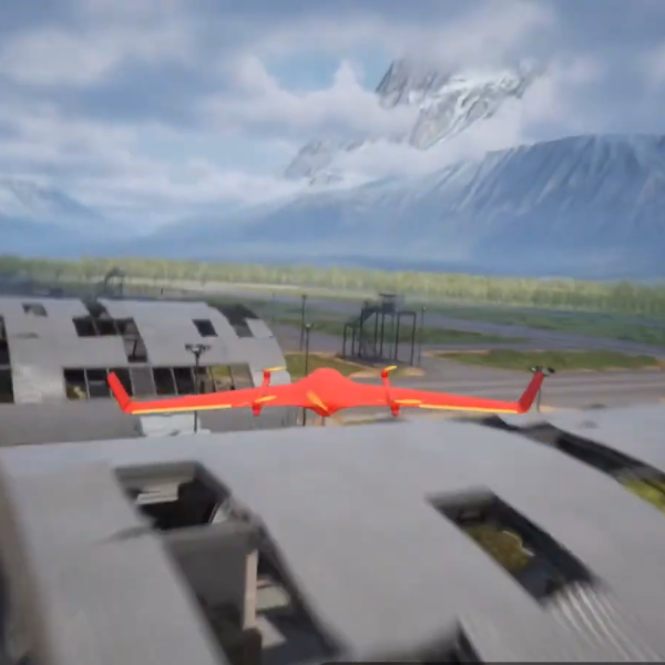

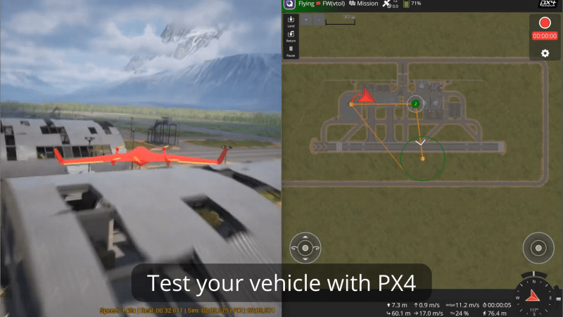

PteroSim is intended as a comprehensive test bench for simulating autonomous aerial vehicles. It can run PX4, ArduPilot, and Betaflight binaries right in the simulator. The autopilot code is given simulated sensor data, and in turn responds with actuator commands, just as it would in a real craft. The simulator runs the flight dynamics using JSBSim, and the resulting scene is rendered in Unreal Engine 5.

  1. Hi Mystick! PteroSim is a standalone app rather than a plugin. We are trying to take the best parts of classic flight simulators and combine them with a modern stack aimed at UAV development.

    1. Hi Pawel! Yes for anything rendered. Cameras capture through the full Unreal
      post-process chain, so lighting, weather, shadows and occlusion land in the
      frame without us propagating them explicitly. Weather switching mid-flight:
      https://www.youtube.com/watch?v=4QMwmZL_3O4
      IMU/GPS/baro come from the dynamics state with seeded noise models. Lidar is
      in active development. Domain randomization isn’t built in yet: the API to
      script it exists, but materials and textures aren’t exposed.
