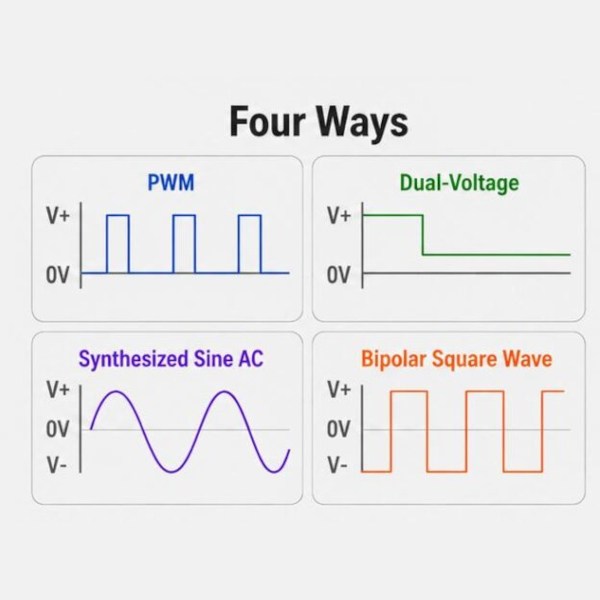

  5. If the bridge uses ordinary MOSFET gate drive with no slew control, would expect EMC trouble. A 45-Hz square wave with deliberately slowed 10–50 µs edges, on the other hand, could be made very benign.
    24VAC is well suited for the outdoor environment.
    1. Good point. The experiment didn’t consider slew rate. At 45 Hz there’s plenty of room for it — gate resistors / RC shaping on the discrete MOSFETs, or a proper gate driver with controllable slew rate.

    1. “PWM is needlessly complicated” — correct, which is precisely why Methods 2, 3 and 4 exist.
      “They’re just an on-off device” — yes, but that describes the logic state, it says nothing about the waveform. Your transformer outputs a sine wave, which is not a flat line. Same with Methods 1, 3 and 4. Method 2 is the only one that’s actually a flat line.
      Transformer’s reliability isn’t in dispute either. The tradeoff is that AC transformer pushes most of the fault-protection burden downstream to the controller, while USB-C brings regulated output and built-in overcurrent, short-circuit and thermal protection upstream.
      Sure USB-C isn’t inherently weatherproof, but neither is an AC transformer — both live indoors or in an enclosure. The field wiring, the splices and the valves remain the same either way.
      It’s not just my take. Rain Bird, one of the industry leaders, laid out several reasons for moving away from conventional iron-core transformers. See a patent they issued more than 10 years ago: https://patents.google.com/patent/US8901771B2
