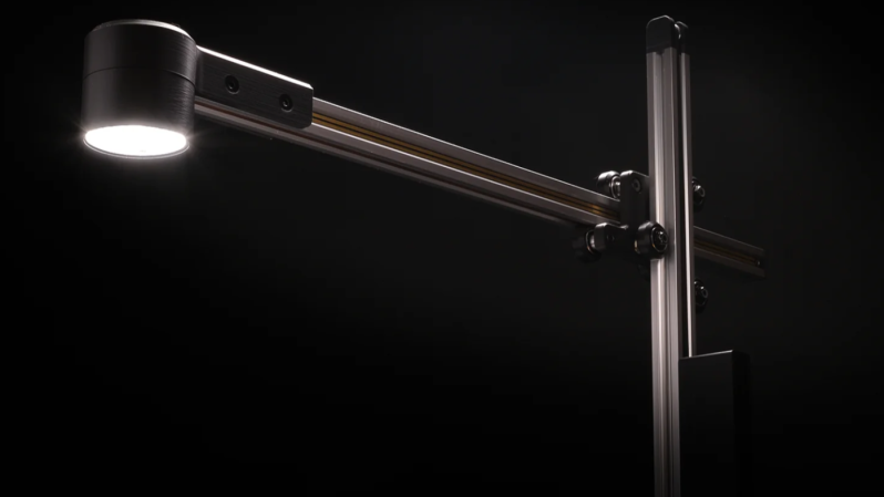

A few years ago Dyson released a desk lamp that could slide up and down, in and out, balancing itself at every position. [Steven Bennett] saw that lamp and wanted to make his own. From this passion, the Open Task Light was born.
We covered the prototype of the Open Task Light back in 2023, and the project is a superb example of iteration. In his 15-part video series on the lamp, you can watch him take on each new aspect of the light, improving the mechanisms, electronics, and production. All those small changes add up to this beautifully finished product.

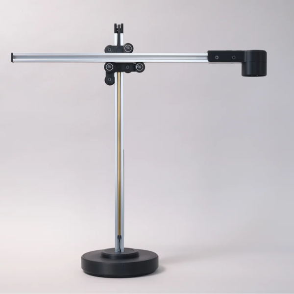

The first thing you’ll notice about the lamp is how little there is to notice: just a pair of extruded aluminum rails with a lamp head on one end and some rollers in the middle. Look a little closer at the rail and you’ll find a PCB running its length, feeding the lamp through pogo pins and leaving no exposed wires. The lamp uses a heat pipe to dump the LED’s heat, again hidden inside the aluminum extrusion. An ESP32 talks to a dedicated LED driver that runs a Cree high-CRI LED. The base comes in several variations for freestanding use or clamping to a table, and it rides on bearings so it can rotate as freely as the lamp’s other axes of movement.
The original lamp this was inspired by carries a hefty price tag, and while the 50-plus-part BOM on this one adds up, it still comes in at well under half the price of its inspiration. The best part: the Open Task Light is open. You can make it your own, head over to [Steven Bennett]’s GitHub to check out the parts. He has also published a well-documented guide on assembling the Open Task Light.

      1. What I mean is that traditional architect lamps, perhaps excluding the cheapest models, already achieve a very good balance that gives the impression of a floating lamp while also being more practical in many situations. For example, the arm typically extends from the back and above, whereas a purely vertical-and-horizontal arm configuration is more restrictive, particularly in a busy space such as my work desk. Additionally, they work perfectly with a simple cable to deliver power. This design has no practical advantages over the established ones. I would call this useless overengineering, which only makes sense as a hacker’s dream. Nevertheless, congratulations to the inventor for achieving his challenging goal!
        1. The type you’re talking about also require significantly less space for proper use.
          This type of horizontal bar lamp requires a large cylinder of clear space to prevent hit from the light end when extended, and the rear end when the light is close to the tower.

  2. I remember the original HaD article, I’m glad he finished it to a standard he was happy with, although personally I’m not sure I’d have stuck with it quite that long myself. There are a lot of half finished projects here. It looks great. I quite like the pogo pins with balls on the end, I can see them being useful for a few things. I always seem to get a shock from those telescopic lamps with the exposed conductors, I think I’d like some sort of brush strip or zipper, as long as it didn’t present too much friction. It would be pretty interesting to see if that style of lamp could be electrically actuated and made to follow your hand or a piece of paper.
    1. Same for me, no visible cables is nice looking and cat-resistant, but not kids-resistant – PSU should be capable to survive surges, ideally with power limiter just above max LED power, like lab power supply – set to 14W is enough for 12W LED plus ESP and current is low enough to not be the real problem ~600mA when 24V is used.
      1. I had a Tizio lamp that used it’s metallic structure as conductors for it’s 12VDC. The paint was the insulator. Maybe using the aluminuym rail as the nagative pole and having a single raing on the PCB would have been better?
        1. Contact with anodized aluminum is not as easy task even with fancy pogo pins, so PCB is very nice solution, just current limiting on PSU side (to not hide this open aestetics) or something to cover it like brush cover (not so neat idea) will do the job.
