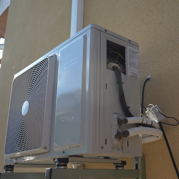

Modern heat pumps, of which air conditioners are a subset, seem like simple machines in theory. They just move heat from one place to another. But in order to operate efficiently, they need specific temperatures and humidities on either side of the pump or they can behave in non-ideal ways. [GreatScott!] noticed this when his air conditioner worked well during a heatwave, but started acting anemic once the outside air temperature cooled down. At once point it was barely able to bring his indoor house temperature below the temperature outside, and he went on a deep dive to investigate why this would be and then found a way trick his air conditioner into working outside its designed temperature range.
Many things can cause this behavior, and some of them are indicative of malfunctions like low refrigerant levels or problems with the compressor or control circuitry. But [GreatScott!]’s unit is pretty new so it was unlikely to be something like that. To investigate, he built a circuit with a small heater which is paired to the outdoor heat exchanger’s temperature probe, tricking the control circuitry into working in a different mode. With a few temperature sensors inside and outside, this was enough to kick the air conditioner into high gear and start outputting cold air again.
While noting that we aren’t HVAC experts, there are a few things that could cause this. One of which is high indoor humidity which might be likely for Germany in the summer, or the outdoor condenser needing a certain temperature or pressure range to operate efficiently. Whatever the case, [GreatScott!] decided to remove his creation to keep from inadvertently damaging his air conditioner. It is possible, however, to use a bit of machine learning to find out more about why one’s HVAC system isn’t behaving as well as it should.

    I’m not an expert either, but this doesn’t sound plausible. When the outside unit is getting rid of heat, the cooler the outside air is the better.
    If I were to bet, I’d say it was high inside humidity and the system’s protection against icing of the inside unit.

    2. At low outside temperatures with a fixed orifice metering device, the cooling capacity drops off. Need to slow down the outdoor fan to keep the pressure differential high enough across the metering device to maintain cooling capacity.
  3. In case it’s not clear from the article, in the video it is explained that the AC system has different working modes dependent on the outside temperature (he also shows the table in the service manual), and his problem was that the house was heated up from the heatwave but due to outside temperatures being low(er), the AC was not able to bring down inside temperatures.
    Simulating a high outdoor temperature with the heater, he was able to get the AC to work, so much so that he got icing on the inner vents.

        1. He got icing because manufacturer didnt bother installing temp sensor on the indoor head? and instead hardcoded that stupid table from the manual. Good unit would notice and bump up in-house airflow.
    2. His system was working at a low stage due to excess humidity. If he had waited for the system to do it’s job, and drain away the liquid condensate, he would have seen it begin to cool more efficiently. Instead, he hijacked it’s operations and got a frozen condensate, blocking his evaporator coils, and making the problem worse.

  6. HVAC control system designer here:
    This is almost certainly a trick to hit an efficiency goal at the “ratings point.” In America for example, the DoE rates HVAC systems at ONE particular outdoor temperature (a ratings point) to classify them by Seasonal Energy Efficiency Ratio (SEER).
    This AC is probably derating its compressor at whatever the EU’s or Germany’s “ratings point” happens to be, so it can be sold in a higher efficiency category (often with tax credits). It cools better at higher ambients because no one is testing its efficiency there. You noticed correctly that efficiency falls off a cliff when it’s running at a higher speed.
    To deal with the icing issue, you need to move air over the indoor coil faster so it loses less moisture on the way. (Roughly speaking, Dehumidification ~ (AirTemp – CoilTemp) / Airspeed.) Check your filter. Also, I’d look at the fan motor and see if there is a tap that’s unused; that might be a faster speed range you could unlock.
