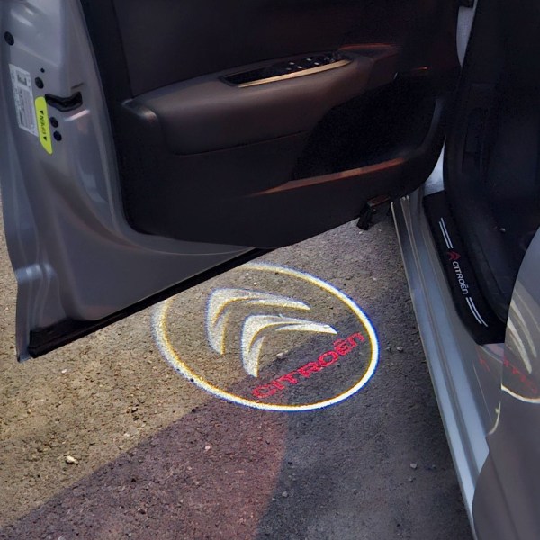

While the Citroën logo they project onto the pavement looks great, [OrangeTungsten] wasn’t thrilled with how their door-mounted projectors actually functioned. The mechanism for detecting when they should kick on was a bit too clever for its own good, and needed to be simplified a bit. Luckily for us, the process was meticulously documented for anyone else who might find themselves in a similar situation.

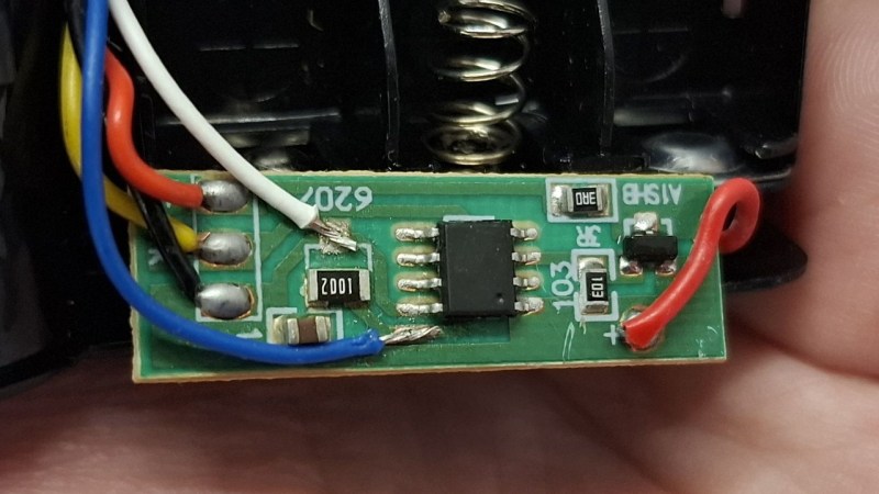

Originally, the projector detected when it should turn on by sensing the presence of a tiny magnet using a Hall effect sensor. There are certainly some advantages to this approach, but in practice, [OrangeTungsten] says the retrofitted magnet would keep falling off and leaving the projector inoperative. The fix was simple enough: figure out how the circuit worked, pull out the Hall effect sensor, and replace it with a simple button that would physically make contact with the door frame.
It’s not a terribly complex fix, but it’s a clever solution and well documented, and that goes pretty far around these parts. We were also interested in this one because an examination of the electronics inside the projector uncovered a 8-pin microcontroller — the sole purpose of which would appear to be polling the Hall effect sensor and using its status to throw a transistor which in turn powers the LED.
It’s hard to believe that whoever designed this gadget couldn’t figure out how to turn an LED on and off without a MCU, but we’re living in strange times. We assume there’s some kind of justification for this, such as some flashing or fading effects, but [OrangeTungsten] never mentions the things doing anything more complex than simply turning on and off.

  6. Are we sure it’s a microcontroller and not just an op-amp, comparator, or LVTTL buffer? All it needs to do is amplify the Hall sensor voltage into a gate drive signal.
    1. Was wondering that myself, I bet it’s just a mosfet fed the output of the hall sensor and is used to switch the higher current of the LED.
