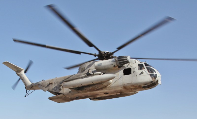

Sometimes you find gold in unexpected places. In this case, it’s from a video about the CH-53 helicopter. The CH-53 Sea Stallion first entered service in 1966. It’s a huge helicopter, capable of lifting immense amounts of weight. All that weight hangs from 6 (or 7 on some models) rotor blades. The problem was detecting problems with the blades before they grew into a catastrophic failure.
Much like a fixed-wing aircraft wing, the CH-53 rotor blades are designed with a spar as the main structural
member. On early designs, the spar was extruded aluminum. The CH-53D and other variants moved to cold-formed titanium.

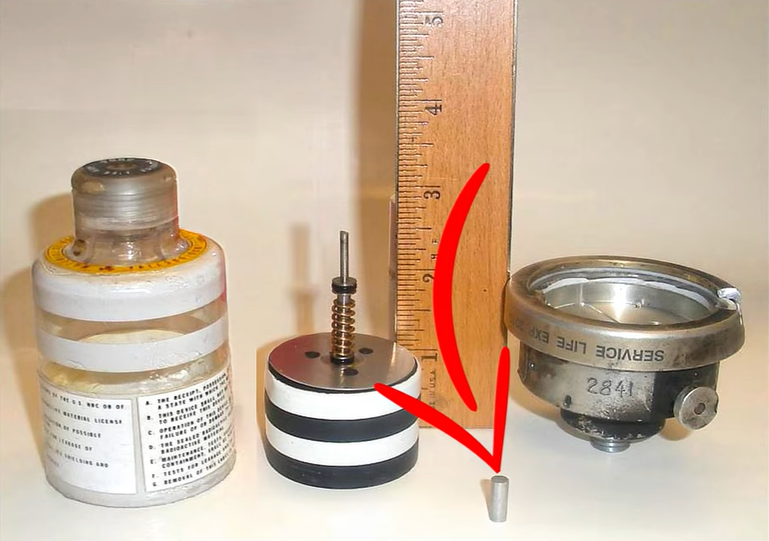

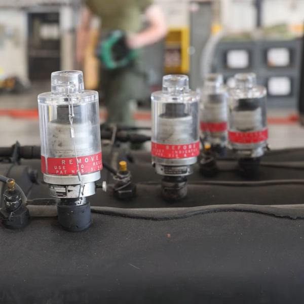

All of these blades shared the same problem – detecting tiny cracks in the metal before they grow into blade failure. Detecting cracks turned out to be rather easy. The blades are sealed and pressurized with nitrogen gas. Cracks allow the gas to leak out. A barber pole pressure indicator on the blades allows mechanics to tell at a glance if everything is ok.
That’s all fine and good on the ground, but if a blade begins cracking in the air, the pilots want to know about it immediately. What was needed was something akin to the tire pressure monitoring system on modern cars. A pressure sensor that would turn on a light in the cockpit. Modern automotive TPMS systems use wireless sensors inside the tire. In the early 60’s though, electronic components were not reliable enough to survive rotating on a helicopter blade. Wiring the sensors through the spinning rotor head using slip rings would be incredibly complex. Expecting wireless electronic components to survive life in a rotorhead would be even more problematic.
The solution turned out to be simple: Throw a little ionizing radiation into the mix. Called IBIS, short for Inflight Blade Monitoring System keeps the CH-53 safe. The magic happens in the same pressure indicator we mentioned earlier. Rather than just a shift from a green to a barber pole indication, the IBIS module also exposes a tiny amount of radioactive Strontium-90. The Strontium is a beta emitter, meaning its radiation can be detected by a Geiger counter inside the helicopter. It’s also relatively safe for humans as long as they don’t eat or breathe it in. No batteries, no electronics on the rotor blade. It’s a simple mechanical solution to a difficult problem.

I do understand your sentiment about the radioactive source. And it is true that Sr-90 is a dangerous part of radioactive fallout. I looked up more information on this and the source is spicy, about 1000 times more activity than a household smoke detector.
The hazards are very small. The sources are on the helicopter blades, quite some ways from the body of the copter. In addition, when the blades are OK the source is shielded inside it’s container. It’s only when the blade losses pressure from a crack that the source emerges. The blade itself will absorb all the radiation. Even in air beta particles have a range of only a foot or so.
The only danger I can see from this scheme is improper disposal. And even then, eating the source would be needed to pose any real danger.

I worked on UH-3h Helo’s when I was in the Navy and we had the same indicator system on our main rotator blades.

MH-53E maintainer here. The system is IBIS (Inflight Blade Inspection System) and the little pods are BIM (blade inspection monitors). The box is pretty obvious sitting just behind the main rotor on the deck above the center engine. I found a random picture on the web: https://assets.verticalmag.com/wp-content/uploads/2017/01/MHM_6001.jpg.
Thank you, the question was prompted by “The Strontium is a beta emitter, meaning its radiation can be detected by a Geiger counter inside the helicopter.”
