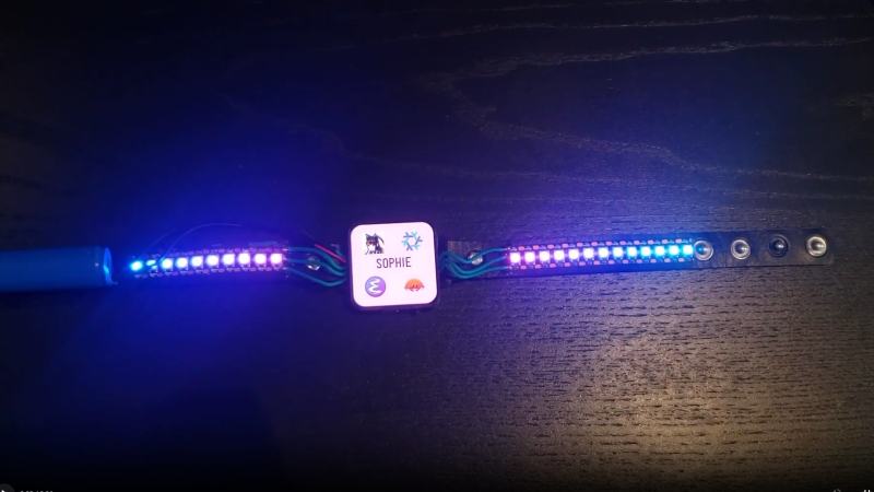

Nifty little AMOLED screens are easy to get nowadays, and [Sophie D] demonstrates they are both thin and light enough to be worn with OpenChoker, a design for a choker necklace that was a hit at DEF CON.

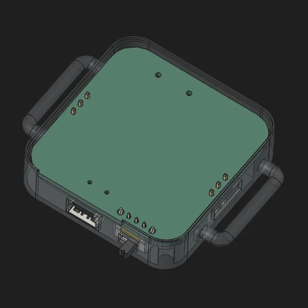

The choker consists of an AMOLED touchscreen flanked by short RGB LED strips. Behind the display is the PCB which contains an RP2350 and micro SD card slot for external storage, and at the rear of the choker is an 18650 cell to power it all. The display plays an eye-catching animation that gets generated on the fly while the LEDs sparkle away.
[Sophie] shares a number of interesting takeaways from designing and building this device. One is that the bulk of the PCB design work was interfacing to the display, since no existing footprint or reference design could be found. So if you find yourself with a Hello Lighting HL020E21-02 2.14″ touchscreen display you’re hankering to use in your own project, do yourself a favor and check out [Sophie]’s board design instead of starting from scratch.

The emacs icon makes me imagine someone attempting to use emacs on this with no keyboard or, worse, some sort of successor to emacs-deldo that tightens as you nest more and more parentheses / layers of indentation.

The touch behavior is likely due to the fact that this module is designed for integration into a phone. The touch front end parameters are tuned based on a specific chassis capacitance.
Here since the enclosure is small and made of plastic, the chassis capacitance is small and cause the touch to misbehave. Another indicator this is the issue is the fact that she observes a better performance when the device is close to her body or connected to a computer.
One way to help (it doesn’t look like the touch controller is tunable) would be to line the bottom of the case with copper tape connected to the system ground. It may help but may not be sufficient.
Extending that ground under the two RGB LED modules may help a little more.
In short more copper area is better in this case.
