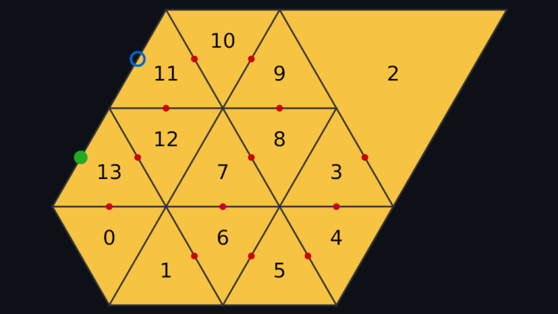

As a company, NanoLeaf has been producing modular lights that can be easily snapped together into various geometric shapes for around a decade. Similar to the addressable LED light strips many of us are familiar with that also became popular around a decade ago, these modular lights are supposed to be easy to configure, customize, and program. But their controllers are notoriously finicky according to [Myrik] who found that a simple ESP32 could be used to replace them when they eventually fail.

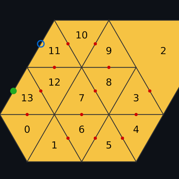

Part of the reason [Myrik] found this to be straightforward is that the company publishes their firmware and makes it essentially available to anyone. Whether or not this was purposeful is not clear; but in either case it only requires slight modification to run on the ESP32. When plugged into an existing string of panels, the panels themselves report their positions and orientations over a single data bus which the ESP32 has no problem interpreting. The ESP32 can also communicate its status over the network, meaning that it can in turn be controlled by any other lighting software a user might have.
