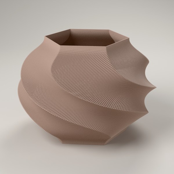

Your CAD software generally has some rudimentary tools for rending images of your parts, from simply-textured models to more photo-realistic options. However, those renders are of the geometry you created—not how that geometry would look after it was sent to a 3D printer. Extrudio is a tool that aims to create more realistic renders for 3D printed parts.

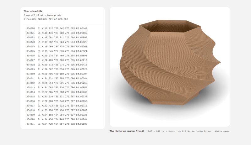

Rather than rendering from the geometry of your model, such as by using an STL file, Extrudio uses G-Code instead. It creates its render based on the instructions your 3D printer uses to produce your part, sweeping a virtual bead of plastic along the toolpaths in the code. In doing so, it can realistically display layer lines in a 3D print and other artifacts of the printing process, like stair-stepping on spheres and curves. It can display the render in various contexts, from blank studio backgrounds to a number of “sets” like a bench or kitchen.
The tool’s website notes that this could be useful for generating images for those selling 3D printed parts online, though obviously the realism of actually printing and photographing a part would still be superior. Still, it could prove a useful tool for quickly pitching realistic images of a 3D printed part, particularly if it’s desirable to model different colors or print techniques without putting in the hours to actually produce them.

  5. I just tried it and this tool is really slick. Works very well. You can select the exact filament brand/type/color you want.
    I sell planters in 10 different colours and this will allow me to generate them in the exact colours I use for uploading to my Shopify site. It can even assemble the planter and its base automatically in the render. This will save me a ton of time and money. And it uses only one credit per image so for $12/month I can generate 100 images, which is more than enough for my needs.
    Yeah, it’s not for everybody, but for a small business like mine this is going to be extremely useful.
