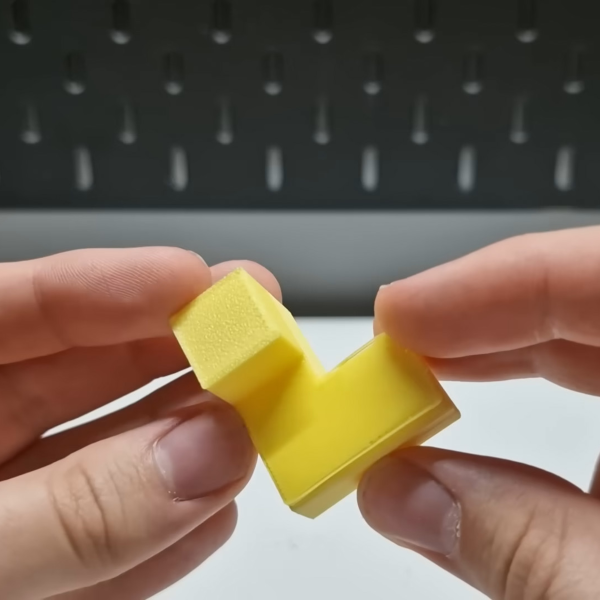

There’s a rule of thumb when it comes to FDM printing that overhangs are really only possible to an angle of around 45 degrees or so. If you try to squirt out plastic with nothing supporting it, it just goes everywhere. However, a new slicer hopes to enable printing up to 90-degree overhangs with some creative techniques.
The software that enables this is called WaveOverhangs, and currently exists as a fork of OrcaSlicer. The idea is straightforward enough — using unique toolpathing to create rings of deposited material that fasten to those laid down before them in the same layer. Thus as the printer lays down a layer into bare space, the deposited plastic is, ideally, able to fix on to the supported edge. As the next ring is laid down, it grabs on to the cooled ring laid down before it, and so on. The idea is inspired by wave propagation, hence the name. You can see a demonstration of the software in the video below by [Cocoanix 3D Printing].
It’s still a very new technique. The slicer has a whole bunch of knobs to turn and two different algorithms. Get the settings just right and you can print horizontal overhangs successfully. There aren’t exactly presets yet, this is something to explore with trial and error. If you test it out, don’t forget to upload your results to the Community Gallery so the developers can see what works and what doesn’t.

  2. i still believe you can’t really print horizonal overhangs, but i have been very pleased that when i have, i have gotten something close to the ‘before’ picture with a bunch of spaghetti hanging under it…and i just take an x-acto to the spaghetti, clean it up, and bob’s your uncle!
    1. I accidentally created a bridge over 50mm long x 4mm wide x 8 mm high (forgot supports). I was shocked by how well the AD5M, in PETG, printed that with only a few hangy strings. (Sliced with Orca)
        1. Using cura, and my old tricked out kp3s, I could do 150mm bridges all day long. Using orca and cc1 and a cc2 and I get 20-30 at best. Not sure whats different, ive validated both machine and filament combos and dialed in adaptive pa in or a. Just cant bridge like i could.
    2. Yes, if you are willing to accept spaghetti then eventually it often provides enough support by itself.
      In addition to an x-acto knife, I have a cheap “deburring tool” that is good for cleaning up concave arches etc.
      But “spaghetti support” is like sending footmen against the castle walls until the bodies make a ramp to the top.
      Wave overhangs are like sending climbing specialists to scale the wall.
