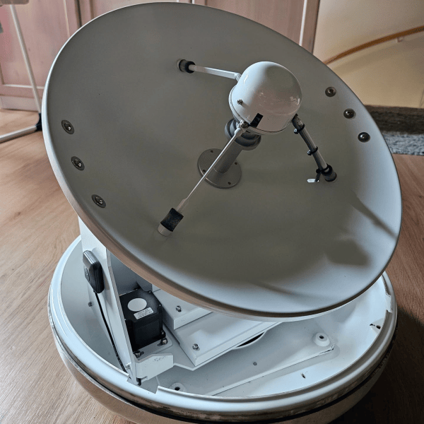

Having watched some fun videos on repurposed satellite dishes on YouTube, [Melan] wanted to get in on the action, managed to source an Intellian i4 — a dish built for marine use — and set about hacking it.
[Melan] first needed to convince the antenna that it was still on a boat by using an RP2040 microcontroller and an RS-422 module to send NMEA sentences. This was necessary to tell the i4 the “heading” of the “boat”, even though [Melan] was really using the rig stationary on land. From there, a simple email to the company itself sufficed to get the Intellian software running on the antenna.
But could it be controlled without the software?. Sniff the communications between the software and the Antenna Control Unit, and decompile the code. This done, it was relatively straightforward to put together a protocol description and figure out how to command the antenna where to point simply by issuing commands for azimuth and elevation.

The sub reflector doesn’t correct the signal, it’s to detect the movement of the ship. The reflector is not centered and therefor wobbles and that causes the signal to continuously vary in the same pattern when there is no movement. When the ship moves in one direction, it senses this in the varying pattern and is able to calculate the necessary corrections of the dish.
I owned one to use for satellite HAM radio but sold it to someone for a lot of money but in the meantime I figured this out. Not entirely, there is more to it but you get the idea of it.

With the motor and a single axix I get the impression it just spins and uses gyroscopic forces to stay in plane and thus “wobble out” smaller waves.
Only larger waves force the disk so far out of plane that some sensor registers it and actuates the actual dish motors.
Is that ^^ (similar to) what you were saying? I don’t get the “wobble” pattern VS. movement of ship at all.
There is not some sensor to detect anything, the documentation stated that the spinning disc (which spins slowly, by far not fast enough to be a gyroscope) causes a correction signal:
https://rfessentials.com/resources/rf-glossary/conical-scan-satellite/

For posterity, here is a slightly more in-depth explanation of how the conical scan function works to keep the dish locked onto a satellite despite the ship rocking in the waves:
