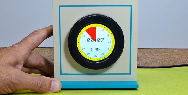

That’s precisely what [mircemk] has done with their “Universal Timer” project. The 2.1 inch CrowPanel “Rotary Display” at the heart of the build combines an ESP32-S3 with a 480×480 round touch screen display and a rotary encoder.
The all-in-one device — clearly meant to be reminiscent of the Nest thermostat and similar commercial offerings — is technically all you need, but in this case it’s been joined by a PCF8574 I2C I/O expander which in turn is used to drive a buzzer that provides a bit of audio feedback at the end of the countdown.
With the code [mircemk] has provided flashed onto the board, the rotary encoder ring built into the housing makes for an exceptionally intuitive input for setting the desired time. It’s a bit like a high-tech version of the classic kitchen timer, as shown in the video below, you simply twist the ring and the graphics on the display rotate accordingly. Unlike grandma’s clockwork timer of old however, this one can change color as it nears zero, which makes it easier to estimate how much time remains from across the room.
