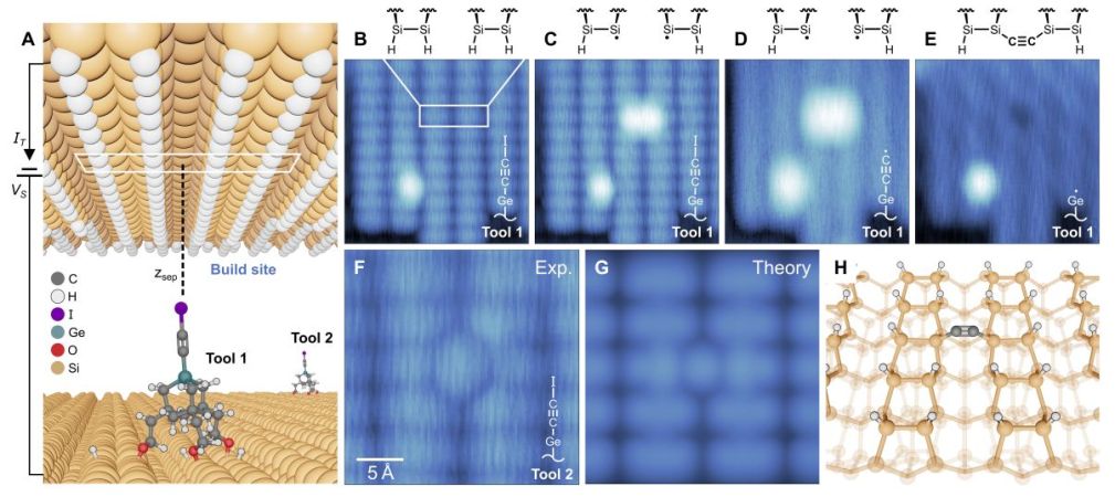

This is demonstrated in a recent (pre-publication) study by [Megan Cowie] et al. using inverted-mode STM. One could say that in a sense what we’re trying to accomplish is somewhat akin to what biological cells do in their ribosome, where compounds are synthesized into a protein string using a template. The difference here being that rather than merely trying to create a 2D structure that then folds into a desired shape, we would like to build 3D structures directly.
Using a scanning tunneling microscope (STM) you can measure a surface on a nanoscale, with the inversed principle used in inverted-mode STM (IM-STM) to physically move individual molecules. In the paper the construction of carbon-based 3D structures using IM-STM is demonstrated.
In the paper it is demonstrated how C2 units can be moved using the tip of an IM-STM setup for subsequent polyyne structure construction through C-C bond formation at the target site. Although it’s not quite yet the leap into Neal Stephenson’s The Diamond Age with its science-based matter compilers – i.e. molecular assemblers – it’s definitely another step closer to making advanced feats of nanotechnology a part of every day life.
