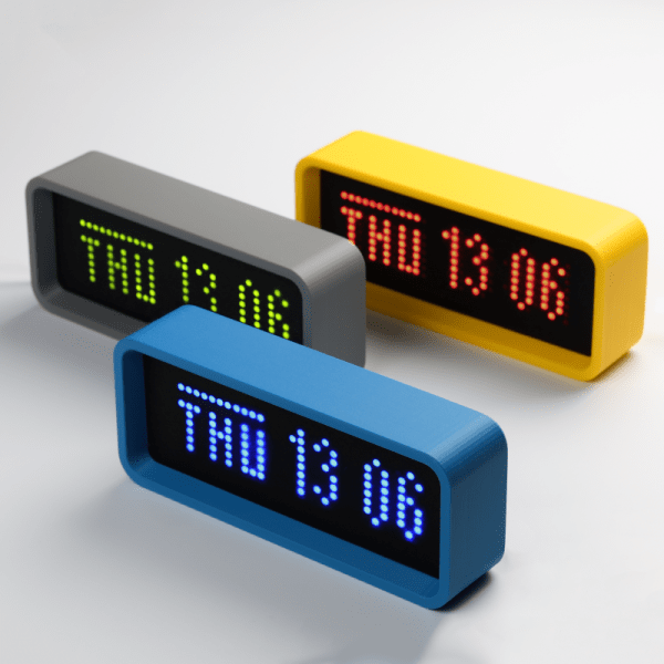

Just about every laptop, desktop, and smartphone in your life can tell you the date, time, and current weather predictions. However, sometimes it’s nice to have simple data displayed on a bespoke device. That’s what inspired [Mario] to create ESPTimeCast.
As you might have guessed by the name, the project is designed around the ESP32 and ESP8266 microcontrollers; either one is up to the task of running the show here. Both come with Wi-Fi connectivity out of the box, which makes it easy for them to hook up to the Internet to query NTP servers for the time and weather data from OpenWeatherMap. The data is then displayed on an LED matrix display, made up of four 8×8 LED modules and driven with the aid of the MAX7219 IC. Configuration is handled over a simple web interface hosted on the device itself. All the parts are wrapped up in a 3D-printed housing that would be very fitting in any home that appreciates the magic of late 60s/early 70s decor.

  2. If I want to make that clock, what would I use as the protective screen in front of the dot-matrix leds? It looks like smoked plastic or glass.
    1. The one in the picture is a 1 layer thin 3d printed diffuser, but yeah, you can use acrylic if you dont have access to a 3d printer ;)
    2. I made mine using wood veneer. It is a very good diffuser, and looks amazing. The leds are more than bright enough to shire through the veneer.
