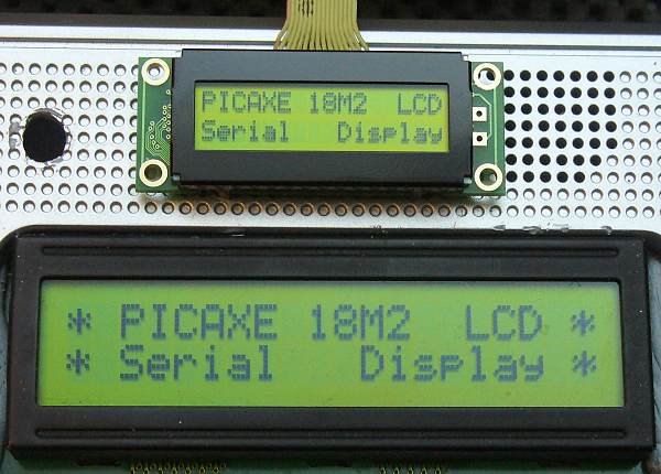

One thing that always strikes me about the alphanumeric displays on the market is the sheer size of the accompanying circuitboard(s) needed to drive them, it makes you wonder how small you could make an LCD meter using the miniature 16×2 screen used on the neat DIY scientific wristwatch
Especially when you compare the size of a miniature 16×2 with a standard sized 20×2: http://www.haku.co.uk/pics/PicaxeMiniLCDDisplay2.jpg
It also solves the problem of running a 5v LCD from a 3v coin cell, using a very simple boost circuit consisiting of a capacitor, two diodes and a PWM signal, as shown on the uWatch schematic and noted in tip 10 of a rather useful set of tips & tricks from Microchip: http://ww1.microchip.com/downloads/en/devicedoc/40040b.pdf
