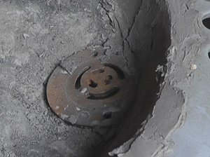

Put the Cement in the Sink
The trick is to melt the stock iron, but not the iron bowl so I lined the sink with refractory cement. My first batch of refractory cement came from a bag of refractory cement powder from a local sand, cement, and gravel quarry outlet.
I mixed the cement and applied to the inside of the bowl some time ago. This year when I moved the forge into my new building (it was the building before this that cost me a finger) I realized that some of the sandy cement mixture had been washed away; probably during a recent hurricane (we have had a couple of hurricanes go directly overhead recently including Sandy). This time I went to the local hardware store and grabbed a container of premixed refractory cement… or maybe it was Amazon. A quick slather and set and I had a pretty reasonable coating protecting my powder blue sink.
Finally the piece that I purchased on this redo of the forge is the metal piece that covers the air inlet known as the tuyère which is spelled tuyère but is otherwise unpronounceable. I do know people that think they know how to pronounce it, they are mostly wrong.

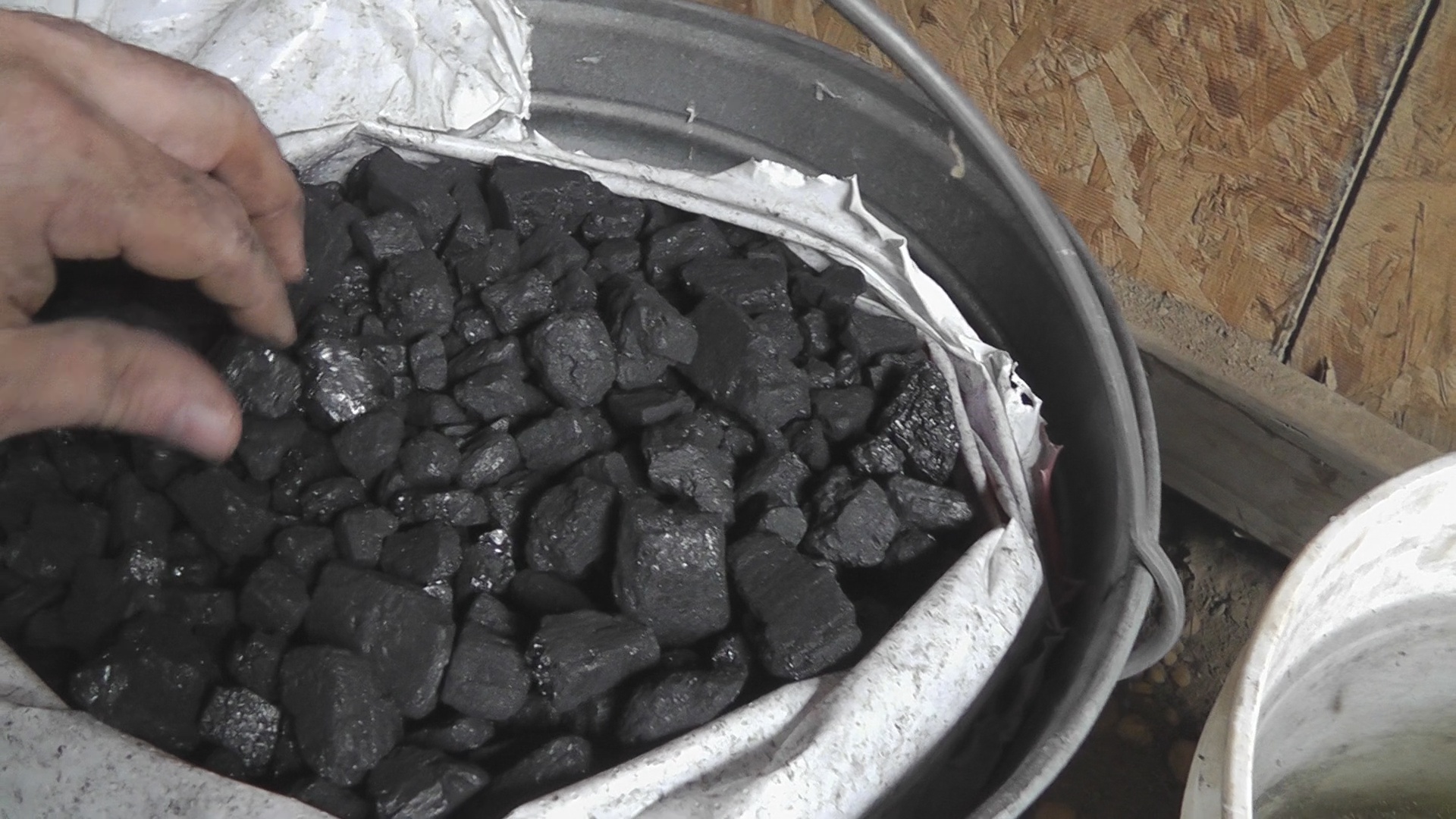

Finally the coal: basically you want, you need, blacksmithing coal. If one were to burn the coal used by the power industry one would find one’s self on one’s back from the sulfurous fumes (and other carcinogenic chemicals best left to the big power plants to release into our atmosphere). I got my first batch from a blacksmith in Delaware where I bought my anvil, sadly the container it was in was not hurricane proof and I found a bog-like watery sludge when I started to shoot this video the first time.
This last batch of coal I bought online from Centaur Forge. Their shipping was included, which is something to check so that you don’t effectively double the cost of a bag of coal. The chunks are between ¼” and ¾” where I was used to ¼” to ½” but otherwise it burns clean, very low sulfur and metal bends in its presence when heated.
Starting the fire is still somewhat of a pain. Many people use newspaper and coal dust, some use pine needles, I use lighter fluid. Even with half a bottle of Kingston™ I found that you still have to make a pocket in the coal that has direct air flow from the blower and allows the edges of the coal to catch. The sign that the coal really is catching is that smoke starts to waft up and has a slight green tinge to it, possibly one reason it’s called green coal.
There are a couple of byproducts of the coal burning process other than the occasional blister: “coke”, a purer form of carbon, and “clinkers”, the byproduct of the impurities. Coke can be strategically moved to make a hotter fire and help impart carbon to iron (carbon+iron=steel) or to help start a fire (coke+lighter fluid =fire). Clinkers kind of look like coke, they are mostly black, clumpy things, which will actually choke a fire if not removed. They do make a clinking noise when struck due to the amalgam of carcinogens and metal-like residue.

Article insinuates coke is an accidental byproduct of coal fire, when it is in fact the point to a blacksmith fire. After the fire is started an hot, you wet the burning coal and it will steam out the impurities and make it coke. THEN you start heating your metal and working. You may get away with some smithing without coking your coal, but why? It critical for forgw welding, and it makes the fire alot more pleasant after all the sulfurs gone.
Pretty sure you can just buy coke, I know my Grandad did, back in the days when people had coal fires. Actually it was the 1970s and 80s, he was just tight with money. Had an old range cooker too, people pay a fortune for those nowadays. My Nana would’ve killed for a gas cooker!
It was my Grandad who gave me the great piece of financial advice that so many people seem not to be aware of. You can’t make a profit by selling your home. Because however much the value has gone up, the prices of all the others houses have gone up too. You still need somewhere to live.
I think coke was sold for use in towns where there were emissions rules over smoke, coke burns with little smoke, since it’s mostly pure carbon. It’s produced just by heating coal with no air, similar to how you make charcoal from wood. I think some blacksmiths use charcoal too sometimes. It’s not something I know a lot about, the steam method is surprising, wouldn’t have thought it would work so quickly, or using water. I knew coke burns hotter though, and with less flame.
Yeah, you dump the water in the fire and a huge plume of yellow sulfur smoke gets released instantly. I don’t know how it happens so fast, but it does! It’s real bad stinky for a minute, then gets pretty clean…I use WV coal from local mines cause it was available, pain in the ass cause you want homogenous size peices, so you gotta break it up, but after its coked its fine though, but you do have to check for clinkers often with it.
Centaur Forge for example has coke for sale near the same price as coal.
I would watch a MIG/TIG video, Bill!
When you first build a coal smithing fire, after its hot, you need to wet the coal. This will cause the sulfur and other impurities to “steam” out. You will be left with clean, hot burning coke. You blacksmith from a coke fire, not coal. It’s hotter, cleaner, and much more pleasant after the sulfurs gone. You may get away with smithing from a coal fire, but it is critical for forge welding.
Yup.
From the post: Coke can be strategically moved to make a hotter fire and help impart carbon to iron (carbon+iron=steel) or to help start a fire (coke+lighter fluid =fire)
The wetting of the burning coal is the catalyst to make most of it coke. The whole point of my post was to share the proper coal fire technique of using water to create coke, which was NOT in the article. BTW I have studied pattern welded steel under the late mastersmith Bill Fiorini, and while I am terrible at it bladesmithing, I know how to coke a fire.
