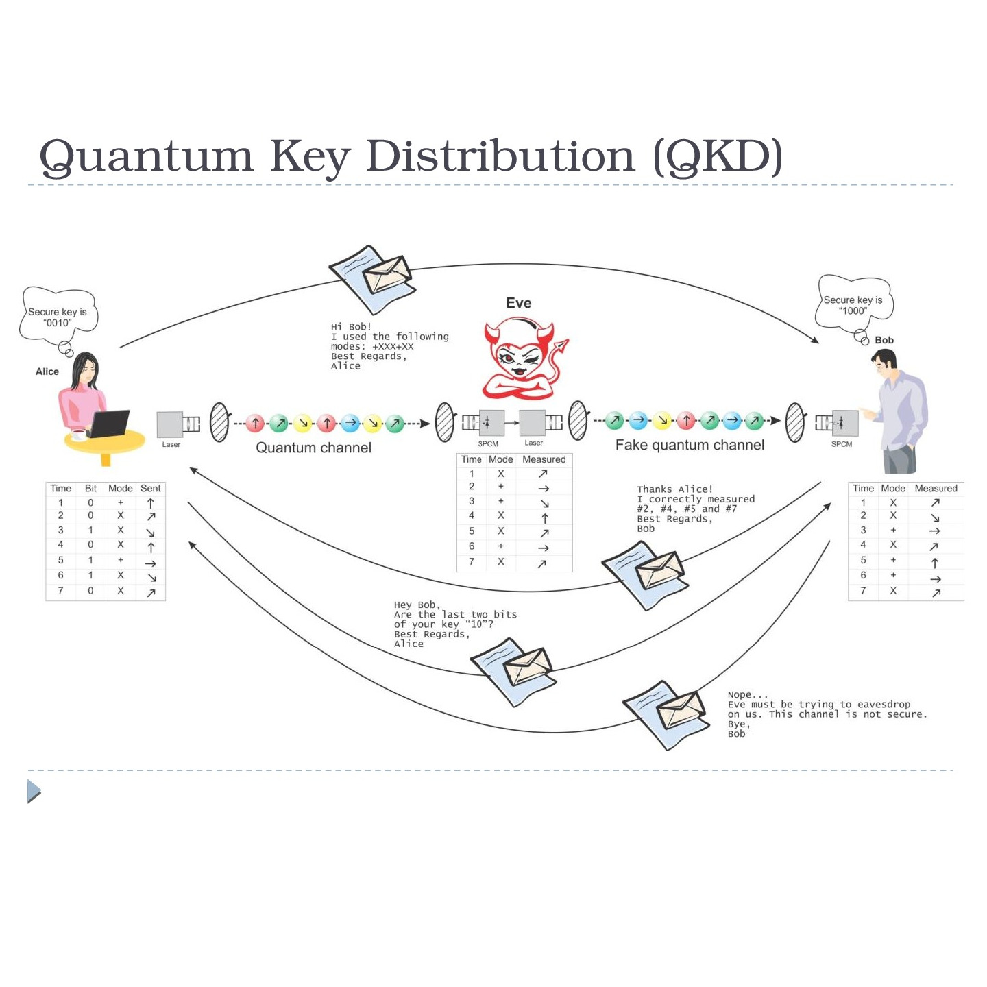

The second application she covers is Quantum Key Distribution. This is a form of Quantum Cryptography where several pairs of entangled photons are used in something of a public/private key pair. The virtue of this system is that it make it possible to immediately detect a man-in-the-middle attack. However, as [Shanni] mentions, there is current research that points to vulnerabilities in this system.
