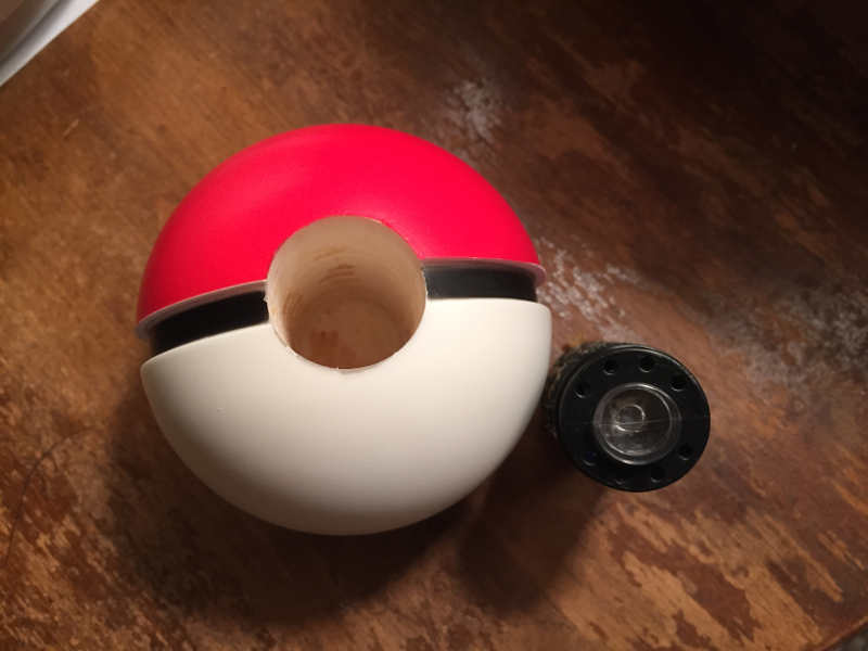

There’s something irresistible about throwing Pokeballs at unexpectedly appearing creatures. But wait. When did you actually, physically throw a Pokeball? Swiping over colored pixels wasn’t enough for [Trey Keown], so he built a real, throwable, Pokemon-catching Pokeball for Pokemon Go.

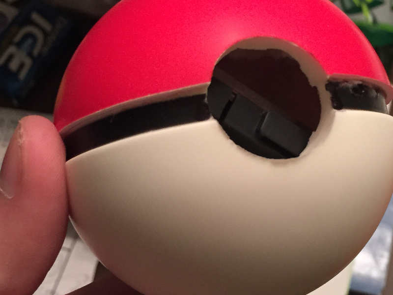

For his build, [Trey] acquired an off-the-shelf foam Pokeball, from which he removed the original “light and sound” guts and some of the foam filling to make space for actual, real Pokemon a TI SensorTag 2.0. This little, self-contained IoT development board comes with BLE and an accelerometer, so on the hardware side, there wasn’t much more to do than stuffing it into the prepped foam ball.
[Trey] went on to write an iOS app that accesses the accelerometer data from his Pokeball. If the acceleration values surpass a certain threshold, his app writes a trigger command to a file that he set up to be regularly polled by a user input emulation macro app named AutoTouch. AutoTouch emulates the swipe that throws the Pokeball in the game.
