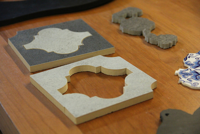

A First Class Showcase
It’s easy to forget that most of the folks building tools for the after-hours engineer aren’t actually cold-hearted salespeople. They’re engineers too–and they’re no exception from the crew of folks who love a good side project. Over at the Hax Accelerator office, I got a preview of some of the side-projects they’ve built using the very tool they’re offering us now.
Compared to a laser cutter, the waterjet is far less limited in what materials it can accommodate. The knife stock above was cut from D2 tool steel and then finished by a professional knife maker. In the middle, the quadcopter frames are cut from FR4 and carbon fiber (Upcycled PCB-copter, we’re going to will you into existence right here!).
Given that the effective tool diameter is only about 1.5 mils (0.0015 inches), the level of detail achievable easily exceeds the finesse of any craftsperson working by hand. The other advantage is the consistent repeatability of parts produced with this tool. It’s not too difficult to imagine tiling an entire wall with the same pattern cut on the same machine.
