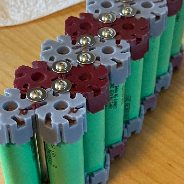

Building a battery pack from 18650 cells traditionally requires patience, a spot welder, and a supply of nickel strip. But what if there was another way? [Ben] is here with Cell-Lock, a modular battery assembly system.
At the system’s heart are a set of interlocking end caps and connection pieces that function as locking cams as well as the electrical connections where needed. They were inspired by the cam systems used for furniture assembly, and are activated by rotation with a screwdriver. The result is a mechanically stable battery system in which different configurations can easily be assembled.
We like that it doesn’t involve any heat near those cells; in part because we’ve seen our share of dodgy connections overheating. But we do have a few concerns. These include how reliable a connection those cams would make, as well as how much current they could safely take without overheating. If both of those could be addressed, we can see that this is an idea with a future.
You can see plenty of examples on the linked project, including an e-bike pack which seems to return no problems. Meanwhile this is by no means the first modular battery pack system we’ve seen.

Yeah, looking at screws in plastic and exactly what I was thinking too. Creep is going to kill them.
Realistically? The creep rate is low enough and the compression loading high enough that the creep won’t overcome it and slacken the rods for quite a while. If a battery pack gets maintenance where you tighten the rods every couple of months it’s not going to be an issue. With a modular pack, why not? Clearly you expect to be doing service on it.
Depends on the plastic used, sure PLA isn’t suitable but ABS, ASA or PC doesn’t creep much. Also the construction, plastic in compression rather than tension will mitigate creep problems.

Don’t use PLA. While I’ve been upbraiding people in the other comments for crying “creep! creep!” without even bothering to check what material is being used, PLA is the exception which does creep. Use practically anything else!
I’ve printed out all these versions using “Abs-like” resin. So far so good, but like most of the rest of this project I need to do a lot more testing.

Thanks! You’re (and most of the other commenters) are right that those are the two main issues with the design at present. In their current state the batteries I’m building are good enough (at currents < 20 amps) but just don’t have the reliability that I’m after. I’m currently trying to redesign the copper parts to better handle vibration, but after that I really need to get solid results on how these connectors behave at higher amperages.

Currently learning this the hard way: none of the copper designs I’m trying really have enough spring in them. The current copper parts do have a dimple in them for this reason, which works ok for now, but I’m after a more robust solution. Tyler’s point about nickel plated springs is a good one I think, I’ll have to pick some up and give it a go.
Yeah sorry about the lack of photos Miles, I need to clear off the bench and take some better ones. I’m interested in the plate/spring idea, but can’t quite envision what It would look like? Would you print each side of the battery as one single piece and then bolt them together?
