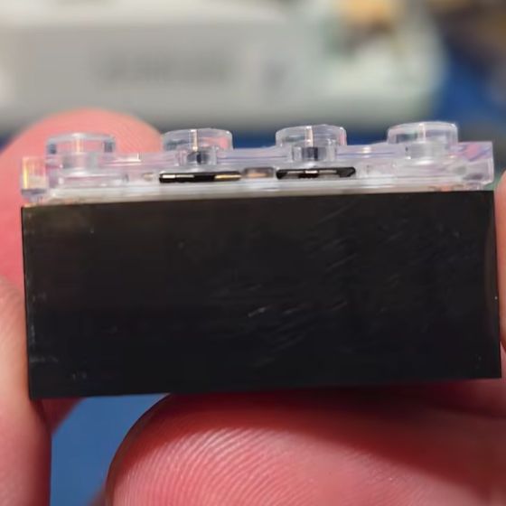

Directly below the transparent top is a speaker, with the opposing PCB on the main body containing a microphone as well as a number of RGB LEDs. On the opposite side of this PCB we find the photo sensor, but to get to this part of the PCB the copper wires that wrap around the entire main assembly have to be disconnected from the PCB’s side pads with some force as they’re apparently pressed in place without the use of solder.
Freeing the main PCB from its plastic enclosure also ended up being fairly destructive, but gave the first good look at its guts. Courtesy of Redditor [PsychologicalYak4619] who previously did a teardown and analysis of such a brick, many details are already available. There’s a separate Bluetooth 5.4 SoC marked EM9305 from EM Microelectronics as well as a 16 Mb Winbond SPI Flash memory chip.
The main application ASIC – marked as DA000001-04 – is the real mystery, which is the marketed custom ASIC. Since this is a flip-chip package, taking a look at the die is super-easy, barely an inconvenience.
On this die shot we can see what looks like CSEM along with some additional letters that may or may not give a hint as to its design origins. This unfortunately means that we do not get any in-depth details on what this ASIC contains and what its capacities are.
Since there is no RAM on the PCB, it appears to at least contain some amount of RAM inside, so assuming that the SPI Flash IC is used by it and not the Bluetooth SoC there might be some hints in the firmware if it were to be extracted.
It’s also of note just how well-sealed these bricks are, making them instant e-waste if anything were to go wrong with any of its components. Considering that the lifespan of Li-ion batteries is generally 2+ years before they begin to significantly degrade, its built-in battery might be the thing that these bricks become the most famous for, not to mention make it run afoul of EU regulations that come into effect next year.

The smart brick is definitely not rinsable. It has holes for the audio to come out.
Good point bebop, but is the speaker cavity exposed to the rest of the case though?
Of course it also has a microphone, so that must have a hole too, and that just sits on the PCB if I recall correctly.
Either way it would be a strange oversight to make a LEGO brick like this then close it up like that and not have the ability to clean it, odd. Maybe there will be an EU edition that you can rinse.
Who knows if there will be such a rinsable brick, but this one certainly isnt. It doesn’t really matter if water will get past the speaker, because it will most certainly destroy the speaker.
