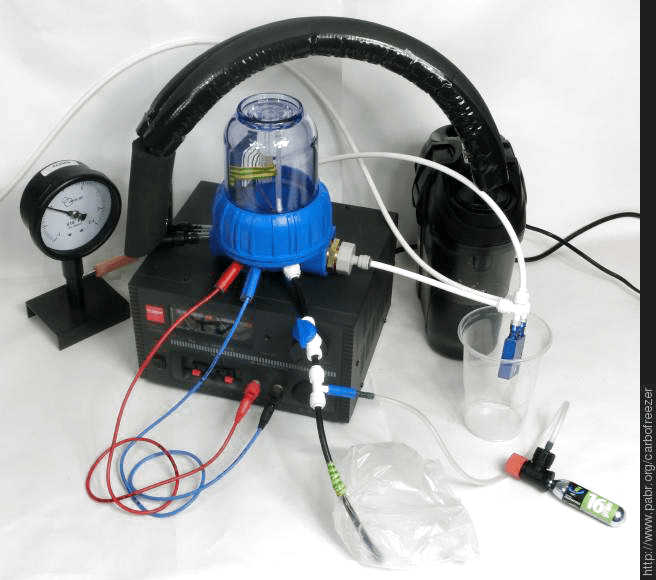

[Pabr] is trying to make dry ice the hard way by building a thermoelectric dry ice generator. The project is a well planned round trip through thermodynamics and cryogenics with a hard landing on the icy grounds of trial and error.
With sufficient cooling on the high-temperature side of the element, it should be well capable of achieving temperatures below -78.5 °C, the sublimation temperature of CO2. So far, [pabr] has built three different setups to expose small amounts of CO2 to the cold of the Peltier element, hoping to observe the formation of little dry ice flakes.

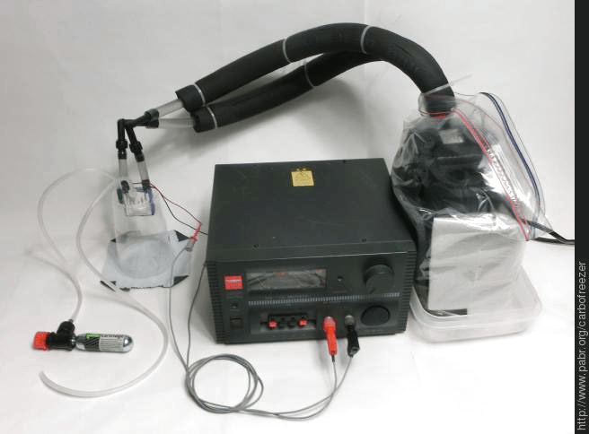

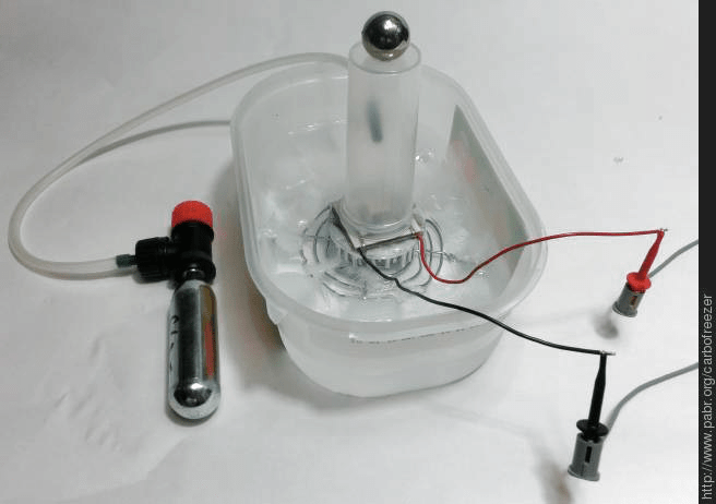

The first setup placed the Peltier element on a massive heatsink, which itself was placed in ice water. A chamber around the element was flooded with CO2 from a bicycle tire inflator. Dry ice was expected to form on the cold tip of the element, but unfortunately, nothing happened. The second attempt was to attach a liquid cooling system with a capable radiator and again, filled with ice water, to the high-temperature side of a Peltier element. A plausible attempt, but again, no success in dry ice production. The third setup moved the experiment to a quasi-vacuum chamber, where CO2 could be streamed onto the Peltier element through a fine needle. The low-pressure environment may have helped with the thermal insulation of the setup, but it also lowers the sublimation temperature of CO2 down to -100 °C. And once again, no CO2 snow formed.
This is not the end of this project, and [pabr] is still working his way toward thermoelectric dry ice production. One big challenge is the acquisition of capable measuring equipment. Thermocouples that are specified for cryogenic temperatures are expensive, and until now measurements have only been taken on the high-temperature side of the cooling element – relying on datasheet values to get an idea of what’s happening on the cold side. Do you have a good idea on how to make this work? [Pabr] will appreciate your suggestions, so let us know in the comments!

What are the parameters for the Peltier devices in the stack? How much of their heat-pumping capacity is being spent just pumping out the heat that is generated in the Peltier device itself? The Tmax temperature difference is only obtained with 0W being pumped. At Qmax power, there is no temperature difference.
Digikey has RTDs for measuring temperatures down to -200°C for about $22. If you only need to go to -70°C then you can get an RTD for under $12 from them.
Exactly, the ‘hot’ side of a Peltier is the heat from the other side PLUS the heat dissipation that results from the power (Volts x Amps) used to power the Peltier so how could stacking them increase efficiency when the progressively increasing heat has to go through each stage to get to the heatsink?
Peltiers make extremely efficient heaters but are not good at cooling.
I think that’s why each stage is smaller than the last, you have more cooling power in each stage to make up for the increasing waste heat. I’ve actually seen this setup for sale on aliexpress before. Peltiers are terribly inefficient, but in this case they’re much easier and cheaper to play with than a cascading heat pump system.
Yes, but the hot side of one Peltier is only in contact with a small proportion of the cold side of another. The power of a Pelter is watts per square dimension so for this to work you would need to cover the cold side of the larger Peltier with copper and then insulate it from air if the temp is below air temp.
The way it is no makes no sense to me at all.
Yeah, I’d have wanted to build it with centimeter chunks of aluminum or copper between each stage, not really because you need more than a couple of mm for the heat spreader, but to give you some room for insulation to be effective in better isolating one stage from another with what I would best describe as sideflow heat leakage, the convection/conduction effects through air within a couple of cm either side.
@RW I really do like the idea of using a 1-2cm thick slab of Aluminium or Copper between each to allow an increased thickness of polystyrene insulation. But each metal block will also act like a thermal reservoir, and the bigger each is the longer it will take for them to cool down. You can never have a positive without some negative. With more insulation the efficiency is increased, but the lag time from initially turning the system on to steady state being achieved will be longer. Something along the lines of this ? https://i.imgur.com/GI8WmMp.png
The configuration seen is often used to cool electronics to a sub zero set point but only really for components that do not require large amounts of heat dissipation, It is possible for example to cool a camera or a photodiode (to improve it’s thermal noise levels) or a control the temperature of a laser diode (say to stop wavelength shift due to thermal effects, or to set the wavelength in the first place). Some thermal cameras also use this configuration to keep their pyrometers cold enough for use.
As you rightly say however the amount of cooling capacity falls off very fast as the stacks add up. I’ve no idea what the latent heat of freezing is for CO2 but you’d need to be able to pump that amount of heat through the peltier stack in order to cause the gas on the end to freeze, otherwise you’ll never have the final stack cold enough to be able to freeze the CO2.
Step one for me would be to get an accurate measurement of the cold temperature. A K-type thermocouple should work — it can be calibrated if you can source some LN2.

Reducing the temperature of the liquid cooling portion with salt might be the easiest way to lower the temperature more (to -20°C or -40°C instead of 0°C). See
https://en.wikipedia.org/wiki/Cooling_bath#Water_and_ice_baths
Exactly, and you don’t really want ice, it is a good insulator, you want a very cold liquid that is a good conductor and you want to move it past the part to be cooled as fast as you can to maximise the thermal gradient at the interface.
He should be using 100% pure (or as close as he can get) ethanol or methanol in a sealed tub for his coolant (to reduce evaporation losses). If he runs it through enough cooling stages, with one stage below 0C that filters out any water ice that may form, that would help maintain purity. Alcohol will remain liquid well below the sublimation temp of CO2.
1. Definitely try to measure the temperature of the Peltier as then you’ll know pretty quickly if you’re achieving close to the temperature to freeze the CO2.
2. One method to try would be to evacuate the sealed vessel as much as possible and then fill with CO2 back up to atmospheric pressure, or above (you may need a better pump, like a diaphragm pump). You probably want to regulate the gas flow rate so it’s not too fast as flooding the chamber will probably prevent it from freezing. But CO2 will sink to the bottom of the chamber anyway, so mount the Peltier at the bottom of the vessel.
3. As has been said already, use an ice/salt bath which will be able to cool the vacuum trap to -20 degreesC.
CO2 is heavier than air so if you only want 1 atmosphere then just put the Peltier in a jar and slowly pour the CO2 in and it will sink below the air and lift push the air out from below.

I’m not seeing any insulation, I’d have Styrofoam around everything that I wanted to keep cold.
I agree
Put pieces of aluminum, ideally an alloy optimized for heat sinks, between the Peltiers so that the heat from the hot sid eof each is spread across the cold side of the next, larger one.
Insulate! The edges of a Peltier need to be insulated so condensation won’t get into it. That can damage the element. You want only the cold surface exposed to the CO2 and the hot side shielded so no warmed air can make it around to what you want to chill.

1) Aerogel as an insulator will maximise efficiency and it can be purchased in small quantities quite cost effectively.
2) Use something other than water for the liquid cooling, perhaps a Glycol based coolant, but you’ll want a sealed system and you might need to worry about corrosion of the heatsink.
3) low temperature silicon potting to protect the peltier elements, or even perhaps a synthetic grease?
4) I don’t know how important the pressure of the CO2 is but you could also make your own CO2 using baking soda + vinegar or yeast + sugar? Save you the cost of the CO2 canisters eventually, especially as yeast is pretty low maintenance.

Thanks for all the feedback ! To address some of the concerns that have been expressed:
– Peltier module selection: I think I understand how these things are spec’ed. Now the question is whether the performance ratings are realistic. I’m already cooling the hot side 22 K below what should work. I can go lower, but antifreeze in the kitchen freezer is a no-go. Also, I have no data on how DTmax degrades at low temperatures.
– Measurements: I wasn’t familiar with lab thermometers with interchangeable probes, so thanks for the advice. Will try that soon.
– Insulation: The pump and coolant lines are wrapped in foam during operation. The Peltier module is now in near vacuum (50 mbar) but I haven’t really estimated conduction leakage, and water vapour from the aspirator is definitely a concern. I haven’t done anything about thermal radiation yet.
– Potting: Manufacturers recommend epoxy rather than silicone. I believe it’s even better to work in a vacuum.
– Ripple: I’m using a 9kg 25A linear PSU rated 3mVpp. These things are designed for amateur radio where switch-mode power supplies are not welcome.
– Use of CO2 cartridges: This is for convenience. Ultimately I should be able to freeze CO2 from dried ambient air. Using water ice from the kitchen freezer is cheating too. The spirit of the project is to make dry ice without any mechanical compression.

A bucket or ice, an aluminium heat sink and a single 6 amp TEC1-12706 can get you down to -50C, so 6 (or possibly 3 if ICE is involved) should if configured right be able to get you down to -80C
https://www.youtube.com/watch?v=qYvsDBf72gA
That video was encouraging, thanks. The block of ice could be well below 0°C initially, so I’m not sure about the 50K. Anyway I can easily get 42K out of a $2 TEC1-12706 (that’s 62% of the rated Dtmax) whereas my expensive four-stage module does only 48K in open air (43% of DTmax) and 60K with vacuum insulation (54% of DTmax).
I actually ran a quick test myself using a block of ice and a 30 mm x 50 mm right angle piece of aluminium frozen into about 200 milliliters of ice, removed from the freezer at -8C. I placed a 40mmx40mm TEC1-12706 partially sitting on top held in very poor thermal contact by gravity and 10 mm of the hot side was sitting in air! But I was able to get the cold side down to -42.4°C before the ice started to melt and the temperature started to shoot up.
I can totally see a much larger heat sink with a large surface area in direct contact with far more ice getting down to -50°C exactly like they did in the above video.
I would experiment more, but I don’t have anything that will measure below -50°C and I only own one TEC1-12706 (at the moment). Still I might try a very large aluminium heat sink with a much larger surface area and freeze it suspended in the water. I would add salt to the ice to drop the starting temperature down to -21.1°C ( http://antoine.frostburg.edu/chem/senese/101/solutions/faq/zero-fahrenheit.shtml) , but it would then probably be below my ability to measure the temperature (currently).
Ultimately I do not think that using ice (with or without salt) would be the ideal solution, but it might help to get some useful calibration data for the peltier coolers, the only curves I’ve seen have the hot side at a constant at 25°C, 30°C, 50°C or 70°C.
Ice is not a great conductor, you can probably get an immersion heater and shove it in a coffee can lump of ice, and have a pocket of boiling water in the middle before it melts it’s way out the sides.
I fully agree, but I’m not using the conduction. I’m using the energy required for the ice to change state from a solid into a liquid. 334 J/g. and to get the maximum benefit from this I need a massive surface area interface between the heatskin and the water, the more surface area the better.
sorry, “ice” not “water”, I really wish HAD added an edit button.
Think several things going on here, not only lack of cooling energy I think too much stacking potentially, too late in evening for me and maths but ….. but surely there will be an in air energy feed back to the previous cooling stages being un-insulated as the petlier underneath the one on top is going to have surface area warmer than that being attempted by the one above. so the air inside would be largely dominated by the largest petliers surface area being presented outside the bounds of the next stage. Ideally you would thermally isolate the 3 lower petliers maybe with aerogel so no surface area losses and each stage gains fullish potential of the stage below.
