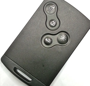

Or just buy a renault that has a very similar keyfob as he just constructed:
http://nebula.wsimg.com/8bb1e85544fa6b9e18cc432028be0032?AccessKeyId=7BE3316720452611F041&disposition=0&alloworigin=1
I own a renault with a keyfob like this and I must say that I like the thickness and size of it.
the problem with the Renault cards is they can easily be bent if, say sat on in a back pocket, then they invariably stop working. and because they are active devices you have a non start condition. they are also a pita to cut open and reshell. have to say in not a fan but plenty folks like the form factor
I’ve had to reshell my old Laguna’s keyfob too … the second time (with a replacement key) I managed to slice into the PCB … nightmare. I’d not recommend buying a Renault whilst they have flexi keyfobs like this – it’s almost as if they’re designed to fail…
