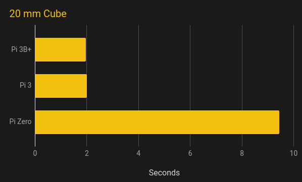

20 mm Cube
We’ll start off small, with a basic 20 mm cube. I generated this STL in OpenSCAD, and it’s about as simplistic a model as they come. Cubes like this are often used during early calibration of a 3D printer, so it seemed appropriate to use it as a starting point for our slicing comparison.
Even this early, we can see how far the Pi Zero is lagging behind its larger siblings. While the nearly 10 seconds it took the Zero to slice the cube is hardly a long time to wait, it’s a troubling sign of things to come given how simple a task this was.
