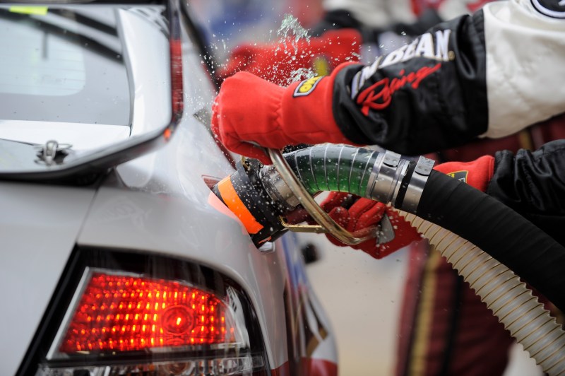

Refueling hose inserted into car
V8 Supercar refuelling with E85 fuel via Getty Images
Race series such as V8 Supercars in Australia and Indycar in the US have used E85 fuels for years now, with the fuel coming with a benefit of reduced detonation, allowing higher performance with the right engine tune. Meanwhile, NASCAR runs an E15 blend.
