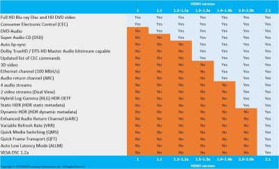

A table showing the feature set of each version of the HDMI standard. However, note that devices labelled as “HDMI 2.1” may not actually support any of the additional listed features. Credit: HDMI.org
The problem with the new standard became clear with the release of a Xiaomi monitor which touted itself as HDMI 2.1 compatible. Despite what it says on the box, however, the monitor included absolutely nothing from the new HDMI standard. No higher resolutions or frame rates were available, nor the useful VRR or ALLM features either. Instead, everything the monitor could do basically fell under the HDMI 2.0 standard.
Amazingly, this is the appropriate thing to do according to the HDMI Licensing Authority. In response to queries from TFT Central, the organization indicated that HDMI 2.0 no longer exists and that devices could no longer be certified as such. Instead, HDMI 2.0 functionality is considered a subset of HDMI 2.1, and new devices must be labelled with the HDMI 2.1 moniker. All the new features of HDMI 2.1 are considered “optional,” and it is up to consumers to check with manufacturers and resellers as to the actual specific features included in the device.
Other embarrassments have occurred too. Yamaha has had to supply replacement boards for “HDMI 2.1” receivers that were unable to handle the full 48 Gbps bandwidth of the standard, leading to black screens when customers attempted to use them with high-resolution, high-framerate sources. Even with the upgrade, the hardware still only supports 24 Gbps bandwidth, leaving them unable to provide the full benefits of HDMI 2.1 functionality. Other manufacturers have faced similar woes, surprisingly not testing their hardware in all display modes prior to launch.
