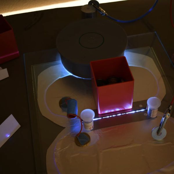

A piece of glass, some bits of tinfoil, a sheet of plastic, a couple of razor blades, and a few assorted bits and bobs are all it takes to build this TEA nitrogen laser. Oh, and a 5,000-volt flyback supply with enough amperage to stop your heart. You’ll need that too.
Seriously, if you choose to follow [MultiverseCurator] ‘s example and build this laser, you’ll want to take the proper precautions. A transversely excited atmospheric laser is simple in concept, but there are plenty of ways for them to go wrong. Unlike the gas lasers used in laser cutters, there’s no enclosed resonator cavity or mirrors. Rather, the excitation takes place across a narrow gap between two electrodes, using atmospheric nitrogen as the lasing medium. This results in hard UV emissions, which means you can’t see them with the naked eye. Add to that the spark gap creating extremely loud discharges as the laser operates, and hazards abound. Proceed with caution.
Construction starts with a flat glass plate and a pair of large capacitors made from aluminum foil plates separated by a plastic dielectric. The razor blades are connected across the capacitors, separated by a narrow gap, with an inductor made from magnet wire in parallel. A spark gap made from nuts and bolts goes in series, and the whole assembly gets connected to a high-voltage power supply — [Multiverse] used a ZVS driver and a CRT flyback transformer with an eight-megohm resistor in series. The video below has all the build details.
It’ll take a little fiddling to get it lasing, and you’ll need something phosphorescent to see the UV light — a scrap of copy paper should do. But the results are pretty amazing for something made from scrap. If you want to take the design to the next level, you’ll want to check out [Les Wright]’s TEA laser build.

The voltage here is too low for interesting x-rays. And with the air gap, the electrons will not have enough energy when they reach the other side of the gap and hit the steel.

It sounds like the x-rays in your link were generated by the target, not the laser itself, which were a CO2 lasers, not nitrogen. Unfortunately, I don’t have access to the fulltext

IIRC the old crt (television) display tubes had electrons at a dozen or so kV hitting metal-ion phosphors, and were required to have leaded glass to reduce x ray emission. The lasers described usually use an old crt transformer to charge the capacitor plates – so there is a similar voltage – and some have copper electrodes as well. Granted there is nitrogen in the discharge gap but it would be worth checking for bursts of xrays I think.
X-rays? Lol last thing you ought to be worried about, and at 5kv? Maybe double check. The spark gaps and dielectric failure are crowd pleasers. Noise, UV, ozone, tiny shrapnel, it’s all good fun.
Built a few of these years ago, they definitely work. Discharge needs to be extremely fast, like a couple nanosecond, or it doesn’t work. Physics. Peak powers can be mind boggling too.
Next up, running them at atmosphere makes lots of hot arcs, but obviously it kinda works. Running them “in a vacuum” means sealing the discharge chamber and pumping it down a little so the discharge is more of a glow discharge. This doesn’t tear up the electrodes either. There’s something else about pre-ionization that helps, but I never tried it. And flowing pure nitrogen is extra bonus power. Make sure the windows where the beam exits are very pure, thin glass or better yet quartz, because the UV can be significantly attenuated. You CAN put a mirror at the back of the cavity to get double power, but because of the physics, its superluminous with high gain and doesn’t require multiple passes through the gain medium. The mirror just redirects the light that falls out the ass-end. They only ever operate in pulsed mode because again physics.
I encourage those so inclined and able to execute safely to try a pulsed N2 laser. See: “Sam’s Laser FAQ” and the other resources mentioned in the comments. Bonus points if you can get a lens that’s UV transparent and cause the air to break down at the focal point.
Have fun, be safe.
The 5 kV and 8 Mohm sounds like you don’t necessarily need a “supply with enough amperage to stop your heart”. Possibly you could manage with a CFL inverter and a voltage multiplier circuit.
