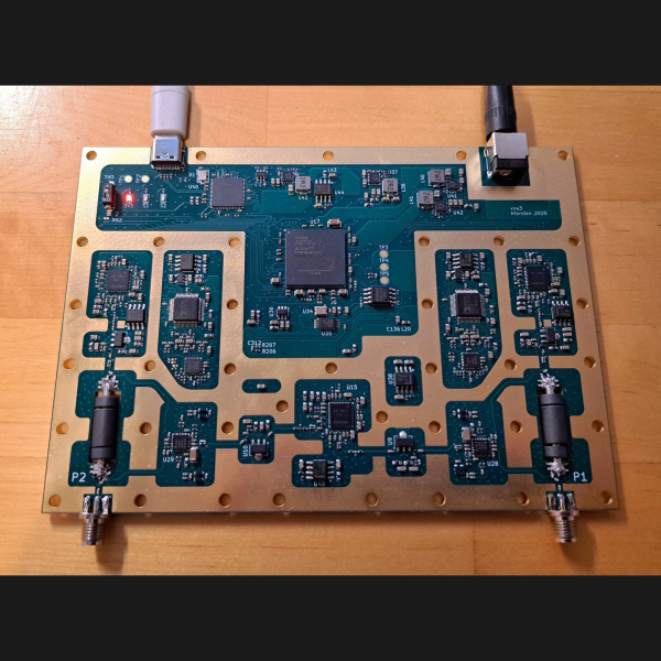

Unless, of course, you build your own vector network analyzer (VNA). That’s what [Henrik Forsten] did, and we’ve got to say we’re even more impressed by the results than we were with his earlier effort. That version was not without its problems, and fixing them was very much on the list of goals for this build. Keeping the build affordable was also key, which resulted in some design compromises while still meeting [Henrik]’s measurement requirements.
The Bill of Materials includes dual-channel broadband RF mixer chips, high-speed 12-bit ADCs, and a fast FPGA to handle the torrent of data and run the digital signal processing functions. The custom six-layer PCB is on the large side and includes large cutouts for the directional couplers, which use short lengths of stripped coaxial cable lined with ferrite rings. To properly isolate signals between stages, [Henrik] sandwiched the PCB between a two-piece aluminum enclosure. Wisely, he printed a prototype enclosure and lined it with aluminum foil to test for fit and function before committing to milling the final version. He did note some leakage around the SMA connectors, but a few RF gaskets made from scraps of foil and solder braid did the trick.

  3. Yeah, soon as I saw the board and the SMAs used I was like “that’s gonna leak.” Been there, done that (as in, had a leaky cavity due to edge-mount SMAs, not built a 15 GHz VNA!). Did the same PCB sandwich trick on that, too.
    If you extend the case a little outward, extend walls upwards to let the PCB fit inside it (so now essentially it’s fully enclosed) with a bit of slop on the holes (just add a bit of slot to them), they make bulkhead SMAs which have panel gaps (so there’s a flush face front/back) so you get a solid seal straight around (e.g. CONSMA006.062). Bit more fiddly to design with but they work really well and they barely cost any more.
    The other option I’ve seen that works is just don’t bother with the edgemounts at all and use a square flange SMA screwed in that extends to a land on the PCB, with ground connection through the enclosure. Downside to that is that removing it requires desoldering the connector, whereas the other ones just slot in. The setups we use need absurd levels of isolation so it’s been a lot of experimentation.
