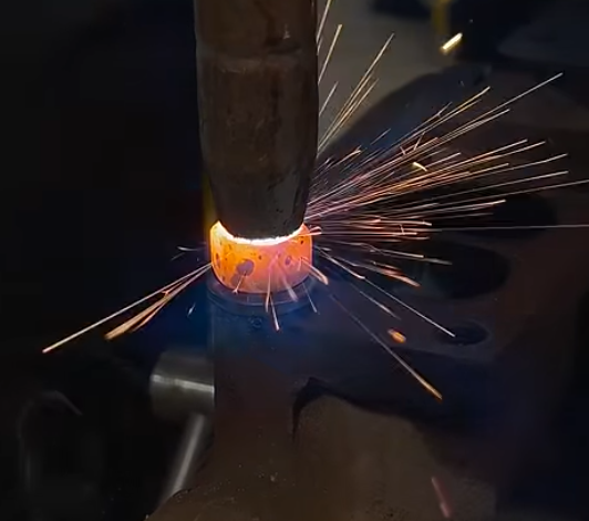

Using A MIG Welder, Acetylene Torch, And Air Hammer To Remove A Broken Bolt
A broken bolt is removed by welding on a hut and then using a wrench to unscrew.
If your shop comes complete with a MIG welder, an acetylene torch, and an air hammer, then you have more options than most when it comes to removing broken bolts.
In this short video [Jim’s Automotive Machine Shop, Inc] takes us through the process of removing a broken manifold bolt: use a MIG welder to attach a washer, then attach a suitably sized nut and weld that onto the washer, heat the assembly with the acetylene torch, loosen up any corrosion on the threads by tapping with a hammer, then simply unscrew with your wrench! Everything is easy when you know how!
Of course if your shop doesn’t come complete with a MIG welder and acetylene torch you will have to get by with the old Easy Out screw extractor like the rest of us. And if you are faced with a nasty bolt situation keep in mind that lubrication can help.

  5. Welding something to the top of a broken bolt has always been enough for me to get it to extract. The heat input and following cooling down is enough to “break” the rusted connection. The second heating of the housing, and the hammering may help, but they have never been needed for me.
    Another important part that is easy to skip over is the wiggling back and through @00:50 in the video. This distributes loose rust particles and/or wears down the little tops of the material that actually form the cold welds ans seize. For many, this seems logical, but I’ve seen a few too many video’s on youtube of unscrewing “stuck” things that do not wiggle the nut around at all.
    And of course, sometimes there is no alternative, if the tread is really galled up, then destroying one of the parts is the only option. sometimes it drilling out the bolt, other times it’s spending a few hours to remove the nut.

  6. I’ve done this so many times. I usually weld on a smaller washer. So with an M8 I TIG weld on an m6 washer and weld a nut onto that. makes my life easier, less chance of it wanting to weld against the casing. Best thing is to leave it alone for a while until it’s cooled off entirely otherwise the bolt is hotter than the thing it’s in so it will have grown in size as a result, making it harder to extract. Give it a while, then heat the outside, and you can extract it with ease.
