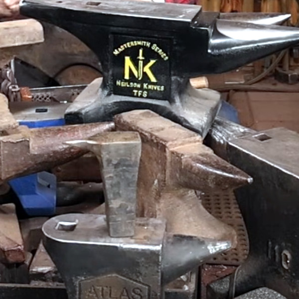

No doubt many readers have at times wished to try their hand at blacksmithing, but it’s fair to say that acquiring an anvil represents quite the hurdle. For anyone not knowing where to turn there’s a video from [Black Bear Forge], in which he takes us through a range of budget options.
He starts with a sledgehammer, the simplest anvil of all, which we would agree makes a very accessible means to do simple forge work. He shows us a rail anvil and a couple of broken old anvils, before spending some time on a cheap Vevor anvil and going on to some much nicer more professional ones. It’s probably the Vevor which is the most interesting of the ones on show though, not because it is particularly good but because it’s a chance to see up close one of these very cheap anvils.
Are they worth taking the chance? The one he’s got has plenty of rough parts and casting flaws, an oddly-sited pritchel and a hardy hole that’s too small. These anvils are sometimes referred to as “Anvil shaped objects”, and while this one could make a reasonable starter it’s not difficult to see why it might not be the best purchase. It’s a subject we have touched on before in our blacksmithing series, so we’re particularly interested to see his take on it.

    1. The vevor anvils are cast steel with really poor quality control. In the video John even shows where it looks like they filled in flaws, and the hardness of the face varies a lot. The Perun anvil is forged steel and being from Poland likely has much better quality control.

    1. For that matter, what is a bad anvil? I’m no blacksmith but doesn’t it pretty much need to be heavy and… what else? Correct harness or something? Thanks in advance
      1. Two holes for holding tooling and doing punching, hard enough to not mushroom, soft enough to not chip, a decently sharp edge along the back for forming over, consistent hardness, a few other options if you’re doing something specialist like making/fitting/modifying horseshoes, massive enough to act like a more or less immovable object.
