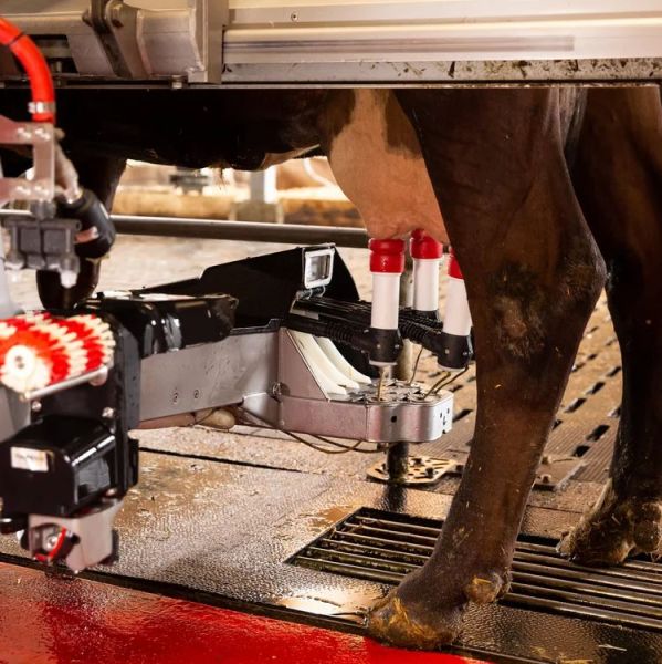

Top image: The milking robot that can automatically milk a cow without human assistance. (Credit: Lely)
