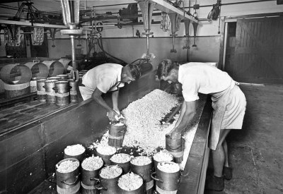

Black and white photo, two cheesemakers bending over a vat of curd, filling cylindrical cheese moulds.
1950s Australian cheesemakers filling cheese moulds with curd. Queensland State Archives, Public Domain.
The milk is heated to speed up the fermentation, the idea being that a warm temperature favours the lactic acid bacteria over the undesirable bugs that might spoil it. Once the lactic acid fermentation is mostly done, the mixture is turned into curds and whey by the addition of rennet. This is an enzyme that coagulates the milk solids, the fat and proteins, leaving a thin liquid, whey, as the leftover.
Rennet is another of those things that can involve some cruelty, as traditionally it would have been produced from the stomachs of young calves slaughtered for the veal industry. Sorry veal farmers — I have never knowingly eaten veal. Fortunately it’s now much more likely to be made commercially from an engineered fungal or bacterial culture, which is why you will see most cheeses labelled as vegetarian.
The cheese is now a big tank full of curd, swimming in whey. The whey is strained off and the curd is broken up. releasing more whey. There is then a process of stirring the curd to release as much whey as possible, which yet again has an effect on the final cheese and is part of those different varieties, and eventually you have a pile of relatively dry fermented curds.

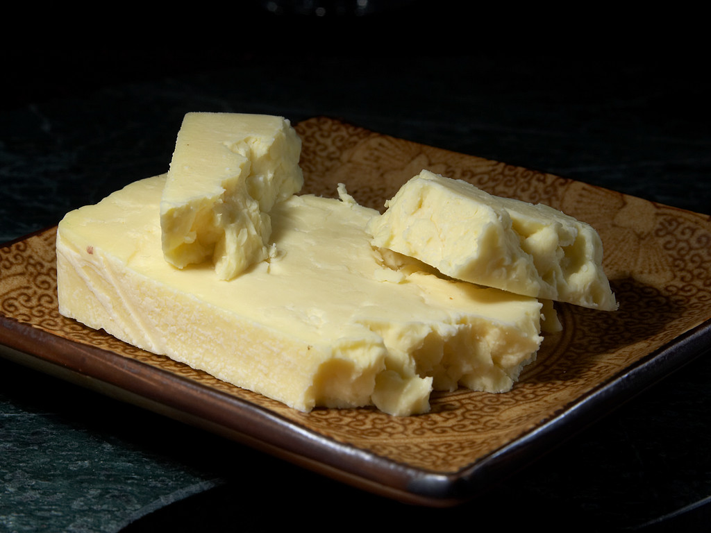

A slice of cheese on a cheese board, with a piece crumbled off.
This is Wensleydale, a crumbly white acidic cheese from Yorkshire, UK. It’s one of my favourites. Jon Sullivan, Public Domain.
