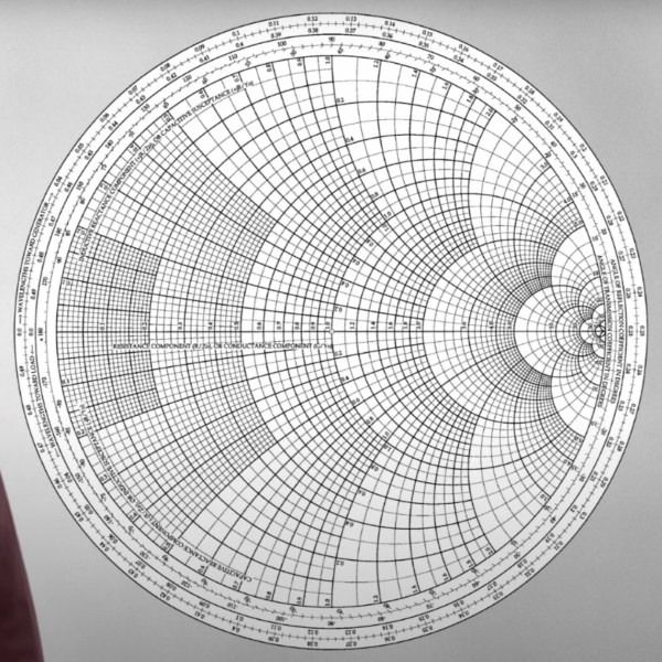

A man is shown on the left of the screen, speaking to the camera. On the right of the screen, a Smith chart is displayed. At the top of the screen, the words "TWO METHODS" are displayed.
Impedance matching is one of the perpetual confusions for new electronics students, and for good reason: the idea that increasing the impedance of a circuit can lead to more power transmission is frighteningly unintuitive at first glance. Even once you understand this, designing a circuit with impedance matching is a tricky task, and it’s here that [Ralph Gable]’s introduction to impedance matching is helpful.
The goal of impedance matching is to maximize the amount of power transmitted from a source to a load. In some simple situations, resistance is the only significant component in impedance, and it’s possible to match impedance just by matching resistance. In most situations, though, capacitance and inductance will add a reactive component to the impedance, in which case it becomes necessary to use the complex conjugate for impedance matching.
The video goes over this theory briefly, but it’s real focus is on explaining how to read a Smith chart, an intimidating-looking tool which can be used to calculate impedances. The video covers the basic impedance-only Smith chart, as well as a full-color Smith chart which indicates both impedance and admittance.

  5. I’ve loved Smith charts ever since I was forced to learn how to use them for an electromagnetic compatibility class in EE college. As long as you can understand the math behind it, they’re a very useful tool.
    1. In this video(and the second one) I think it’s one of the main point that you don’t need to know the mathematics behind the smith chart to use it. The chart is designed so that you don’t need to make lengthy calculations.
  6. Simsmith is a graphical Smith Chart simulation program that can assist with impedance matching without delving into deep math… You can import your antenna impedance from a simulator like EZNEC and apply matching components. You can also import measurements from your NANOVNA into Simsmith and subtract out the feedline, or experiment with various matching. The new improved Simsmith is called SimNEC…
