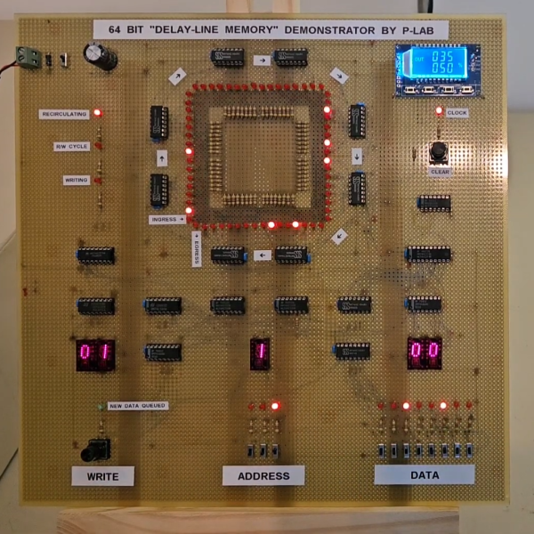

Delay line memory is a technology from yesteryear, but it’s not been entirely forgotten. [P-Lab] has developed a demo board for delay-line memory, which shows how it worked in a very obvious way with lots of visual aids.
If you’re unfamiliar with the technology, it’s a form of memory that was used in classic computers like the Univac-I and the Olivetti Programma 101. It’s a sequential-access technology, where data is stored as pulses in some kind of medium, and read out in order. Different forms of the technology exist, such as using acoustic pulses in mercury or torsional waves passing through coiled nickel wire.
In this case, [P-Lab] built a solid state delay line using TTL ICs, capable of storing a full 64 bits of information and running at speeds of up to 150 kHz. It also features a write-queuing system to ensure bits are written at the exact correct time — the sequential-access nature of the technology means random writes and reads aren’t actually possible. The really cool thing is that [P-Lab] paired the memory with lots of LEDs to show how it works. There are lights to indicate the operation of the clock, and the read and write cycles, as well as individual LEDs indicating the status of each individual bit as they roll around the delay line. Combined with the hexadecimal readouts, it makes it easy to get to grips with this old-school way of doing things.

Whoa, is that a regular vero board it’s built on? That thing is huge! Those 7 segments look like the type with built in BCD logic. Love those, makes things so much easier. Really wish someone would make a modern version. They’re rare as hummingbird dentures but I have a set in my 6800 Heathkit trainer. I really enjoy seeing projects like this, very educational.
Thank you! :-)
It’s an actual Veroboard, 30×30 cm, and the displays are the famous TIL311.
I used them because they have the full hex decoding, unlike 7447 & co., so I also saved 5 ICs from the count.
Too bad, their latch is a bit slow to get the READ_OK signal, so I also had to use a 74HC374… not a big issue, though.
I’d also gladly support a modern and less energy-hungry version.
Maybe a breakout board that comfortably seats a regular 7 segment LED with a tiny cheap mcu handling the logic would be a possible way to recreate the TIL311 but it would be cool if some fab put it all on one die. Wonder what hurdles have kept them from being resurrected to be sold to at least the hobbyist market. Price, patents, or something else? I would definitely buy a set, lower power consumption would be a bonus. I occasionally see originals being sold at ham radio swap meets but the price usually represents the rarity.
