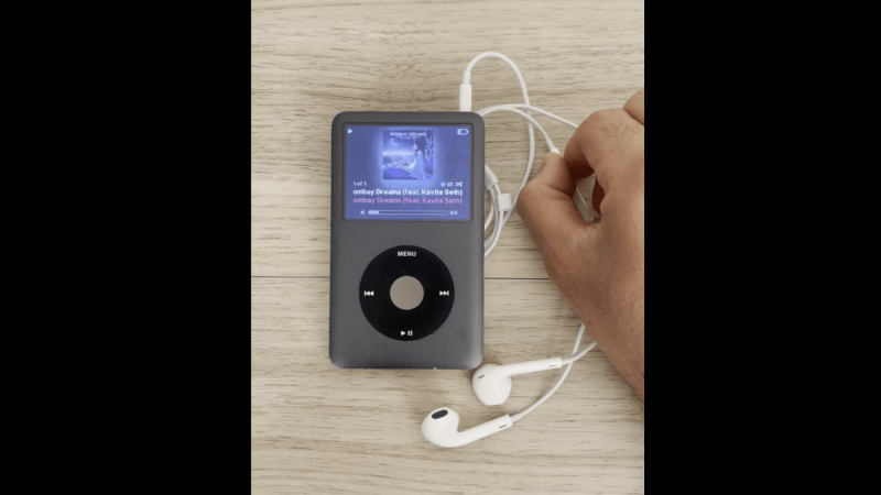

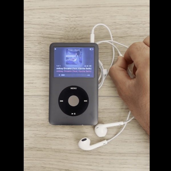

On the old iPods, generally referred to here in the future as iPod Classic, there lives a tiny, undocumented chip called Mikey. It sits at the headphone output and performs only two functions: powering the Apple wired headset microphone and handling button presses from the three buttons. Despite these headphones and iPods having existed for nearly two decades, no one in the open source community has figured out the protocol Apple used for these buttons until now.
As [Hemant] discovered after finding a single archived blog post from 16 years ago about it, the chip is relatively simple by modern standards. Besides handling microphone bias, it sits on an I2C bus and monitors presses from the three buttons on the headset. Each button has its own resistive load, so a press from any of them drops the voltage on the line to a certain amount which the chip can read. The more involved part is a “chirp” that’s a sort of handshake between headset and iPod, which took a bit of work with a debugger that [Hemant] built into a custom Rockbox firmware.
With the chirp sorted out, [Hemant] built the feature into an existing version of Rockbox, and submitted the update to the Rockbox team for integration in future official builds. It’s a long overdue feature for those still using wired headphones and iPods from the turn of the century, but welcome. Some of those iPods are still working to this day, but only conditionally if they’re very cold.

I was 1/2 of the 2 engineer team from TI that designed Mikey for Apple. It was was on a headphone line AND the Microphone line and therefor absolutely had be sub-audio. Since it was on the microphone line we named it Mickey so we would always remember that goal. Apple wanted it quick, cheap, and low low current. and we delivered! How did you find that name? I thought the name was strictly internal.
The article says that the name comes from firmware. Apple likes their vendors to use codenames or custom part numbers for off the shelf chips to (try to) throw off reverse engineering and keep repairs in house.

I do not understand the limitation reported on long-presses. Apple used a lot of long presses both in iPod and iPhone. Hold is text to speech (voice over) of current track. This was later repurposed for Voice Calling and Siri. Dubble click and hold is fast-forward. Triple click and hold is rewind.
From the quick read of the writeup, it’s a software limitation from how the specific driver was written and/or how rockbox (the linux os ported for ipods) handles the input. Of course the oem stock apple ipod os doesn’t have this limitation.

Rockbox functionality still needs a bit of work.
The current build no longer shuts down the iPod by holding down a button on the remote, which is good, but whatever was done to fix that, is now blocking repeat keypresses completely, so it is not possible to change volume beyond 1dB. And the play/pause button still does not work reliably.
Nevertheless, this is a very good start, and [Hemant]’s reverse engineering work deserves recognition.
