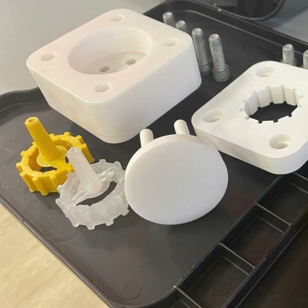

3D printing is all well and good for prototyping, and it can even produce useful parts. If you want real strenght in plastics, though, or to produce a LOT of parts, you probably want to step up to injection molding. As it turns out, 3D printing can help in that regard, with injection molding company [APSX] has given us a look at how it printed injection molds for its APSX-PIM machine.
The concept is simple enough—additive manufacturing is great for producing parts with complex geometries, and injection molds fit very much under that banner. To demonstrate, [APSX] shows us a simple injection mold that it printed with a Formlabs Form3+ using Rigid 10K resin. The mold has good surface finish, which is crucial for injection molding nice parts. It’s also fitted with ejection pins for easy part removal after each shot of injection molded plastic. While it’s not able to hold up like a traditional metal injection mold, it’s better than you might think. [APSX] claims it got 500 automatic injection cycles out of the mold while producing real functional parts. The mold was used with the APSX-PIM injection molding machine squirting polypropylene at a cycle time of 65 seconds, producing a round part that appears to be some kind of lid or gear.
This looks great, but it’s worth noting it’s still not cheap to get into this sort of thing. On top of purchasing a Formlabs Form3+, you’ll also need the APSX-PIM V3, which currently retails for $13,500 or so. Still, if you regularly need to make 500 of something, this could be very desirable. You could get your parts quicker and stronger compared to running a farm of many 3D printers turning out the same parts.
We’ve seen similar projects along these lines before. The fact is that injections molds are complicated geometry to machine, so being able to 3D print them is highly desirable. Great minds and all that. Video after the break.

Durability aside, would a 3D printed plastic mold retain its dimensions over all the parts made in its lifetime? Any heat deformation?
Yes, that’s why the lifetime is limited to a small number of parts.

You can get a small number of parts from a plastic mold.
But you can get thousands of parts from an aluminum mold insert.
Many, many thousands if you hard anodize it, even shooting glass filled nylon.
Less time and effort and much better results.
Inserts are still somewhat disposable, but they all are.
Keep the mold operations guy on a leash, they like to ruin inserts with pry bars and call it ‘extra effort’.
Also Aluminum is a much better heat conductor.
60 seconds+ cycle times for a small simple part is ridiculously bad.
Only very slightly better then not running at all, economically likely WORSE.
You can cut the aluminum insert in less time than printing the plastic one.
Aluminum cuts like warm butter.
Also complex geometries?
Not really…
Simple two part mold inserts can (almost) always be made with 3 axis CNC, or you wouldn’t be able to eject the parts. (Shallow undercuts for part retention are easy enough.)
Making the blank is a separate step, but you can batch those.
60s cycle time means you can do nearly 500 parts in an 8 hour day… which is the entire lifespan of the mold. With 3d printing you’d be lucky to get 10 parts
I also note the 60 second cycle time is a limit of the toy IMM machine.

Working as a mould tool designer this has been coming up regularly for decades. But the reality is that 3D printed moulds have extremely limited uses. Most of the examples are carefully staged parts designed specifically to work. Metal 3D printed mould inserts are really getting interesting with conformal cooling, but are generally more expensive than a traditional machined mould tool.

I’m guessing if you already had an injection moulding machine you could make a carrier plate that retains the small 3D printed mould and allows for quick change, rather than absolutely needing to buy that specific $13k machine.
