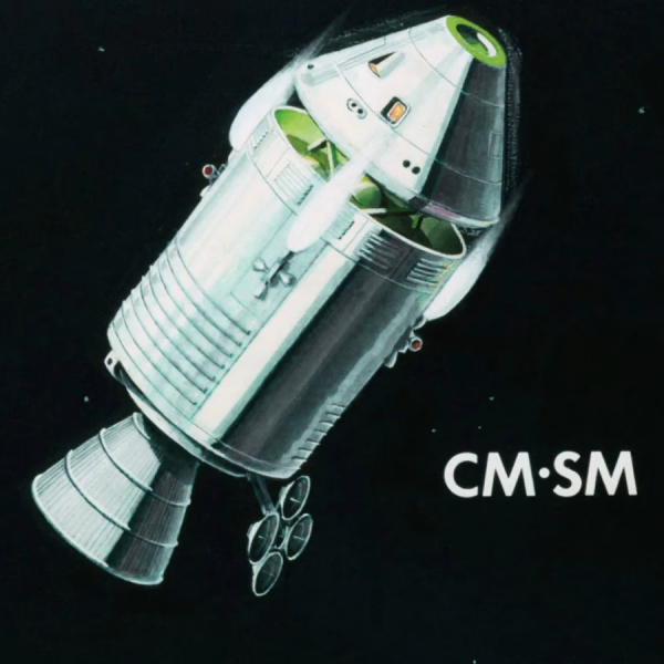

If you’ve watched a Saturn V launch, you’ve probably seen how a large rocket will often jettison a stage on the way up. There are several reasons for this — there is no reason to haul an empty fuel container, for example. However, you can probably imagine how the separation works. You release something — probably explosive bolts — and gravity pulls the old stage away from you as you climb on the next stage’s engines. But what about on the way back? The command module drops the service module before reentry. [Apollo11Space] has a video explaining just how complicated that was to pull off. You can watch it below.
The main problem? The service module has almost everything you need: oxygen, a big engine, fuel, and electrical generation capability. If you’ve ever seen a real command module, they are tiny. Somehow, you need to get the command module prepared to be on its own for the amount of time it takes to land, and get the service module safely away.
In orbit, gravity isn’t a big help in pulling the two pieces apart. For that reason, the mission design called for a very specific orientation for the separation. There are a number of other details you might not have known about.

      1. Gravity pulls equally on both stages in all of those cases, so will not cause them to move apart. You need some deliberate separation mechanism – sometimes springs or pushers, but usually an engine burn by the RCS thrusters or special ullage thrusters used to settle the propellents in the tanks.
        1. But note the author doesn’t say gravity pulls them apart. He wrote: “gravity pulls the old stage away from you as you climb on the next stage’s engines” All literally true and correct, even while it evokes the cartoon image of gravity pulling the discarded stage away (and calls the armchair pedants to action).
          1. Sooo… it’s not, actually, and it’s not really pedantry. Stage separation often happens after pitching over, when the rocket is much closer to horizontal – meaning that gravity acts exactly the same on both of them, close to perpendicular to thrust. I mean, okay, it’s not totally horizontal, so gravity does a little, but it’s actually not “burn and the other stage falls away.” Gravity won’t provide nearly the separation you need in a lot of cases.
            If you have a hot-staged engine (light the second stage engines while still burning), the separation is generated by the thrust of the first – you’re pushing off the first stage.
            Most rockets aren’t hot-staged, and the delay between the first stage being spent and the second stage (a ‘gravity turn’) completes the pitchover, and then you need either a physical separation (e.g. the Falcon 9’s pushers) or additional ullage motors to separate.
        2. There will be a very small difference in the gravitational forces between both parts of of the spacecraft, depending on how they are orientated. eg. if the SM engine was pointed towards the Earth with the CM pointed outwards, the SM would be in a slightly lower orbit, and would slowly move ‘ahead’.
          That said, in low Earth orbit, there would still be some atmospheric drag, but whether the drag would be more or less important than the tidal forces would depend on a lot of factors.
          1. At LEO the two are actually similar scale – people started calling it “micro-gravity” at the ISS for a reason, because most accelerations are at the part-per-million level compared to 1 gee (1 ppm*g = 1 micro-g, see, aren’t we clever). But they’ll be different directionally.
            That’s just in orbit, though – for reentry you’re often moving significantly faster and drag’s going to win.
