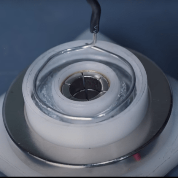

Two rings of magnets are shown encasing a circular channel in a white plastic piece. The channel is filled with liquid metal, and a loop of wire is about to be lowered into the metal.
Almost all satellites have some kind of thrusters aboard, but they tend to use them as little as possible to conserve chemical fuel. Reaction wheels are one way to make orientation adjustments without running the thrusters, and [Zachary Tong]’s liquid metal reaction wheel greatly simplifies the conventional design.
Reaction wheels are basically flywheels. When a spacecraft spins one, conservation of angular momentum means that the wheel applies an equal and opposite torque to the spacecraft, letting the spacecraft orient itself. The liquid-metal reaction wheel uses this same principle, but uses a loop of liquid metal instead of a wheel, and uses a magnetohydrodynamic drive to propel the metal around the loop.
[Zach] built two reaction wheels using Galinstan as their liquid metal, which avoided the toxicity of a more obvious liquid metal. Unfortunately, the oxide skin that Galinstan forms did make it harder to visualize the metal’s motion. He managed to get some good video, but a clearer test was their ability to produce torque. Both iterations produced a noticeable response when hung from a string and activated, and achieved somewhat better results when mounted on a 3D-printed air bearing.
Currently, efficiency is the main limitation of [Zach]’s motors: he estimates that the second model produced 6.2 milli-newton meters of torque, but at the cost of drawing 22 watts. The liquid metal is highly conductive, so the magnetohydrodynamic drive takes high current at low voltage, which is inconvenient for a spacecraft to supply. Nevertheless, considering how hard it is to create reliable, long-lasting reaction wheels the conventional way, the greatly improved resilience of liquid-metal reaction wheels might eventually be worthwhile.

    This metal is ill suited for a reaction wheel because it freezes at -19C. Temperatures in LEO can get as low as -65C. MEO is worse. The wattage budget will be higher than 22 just keeping the metal liquid.

      1. Agreed. Maybe not friction strictly speaking, but the high viscosity is going to result in low efficiency in an application where you probably don’t want to waste energy.
    1. Agreed! It seem only CsNaK might be suited for the job with a melting point of −78.2 °C but I have no idea if it’s ferrous. It also has a nasty problem of being reactive with both air and water. Humanity will need to find a much better metal alloy before this concept can seriously be considered.

  2. I suspect that the energy budget for a mechanical reaction wheel will always be about half of what the liquid metal device would be, all other things being equal, because of the momentum storage in the spinning wheel when you are done changing your attitude.
    You can move angular momentum into and out of a solid wheel, but moving liquid metal cannot energy with rotation because of turbulence, unless it is a superfluid liquid metal. When you are removing angular momentum from a reaction wheel, you can still use it for controlling orientation, only in the opposite sense.

  3. Consider how momentum is transferred: EMF is used to spin up the wheel, moving it from the stator, connected to the satellite, to the free-spinning wheel. Friction (hopefully slowly) then reverses the process, transferring momentum, in the opposite direction, to the satellite. Fluid friction, not turbulence, makes the MHD a poor choice for a reaction wheel. However, turbulence does reduce efficiency, as well.
